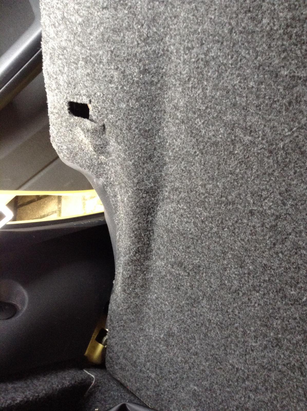

Noticed a ripple in the seat maybe signs of being hit ?

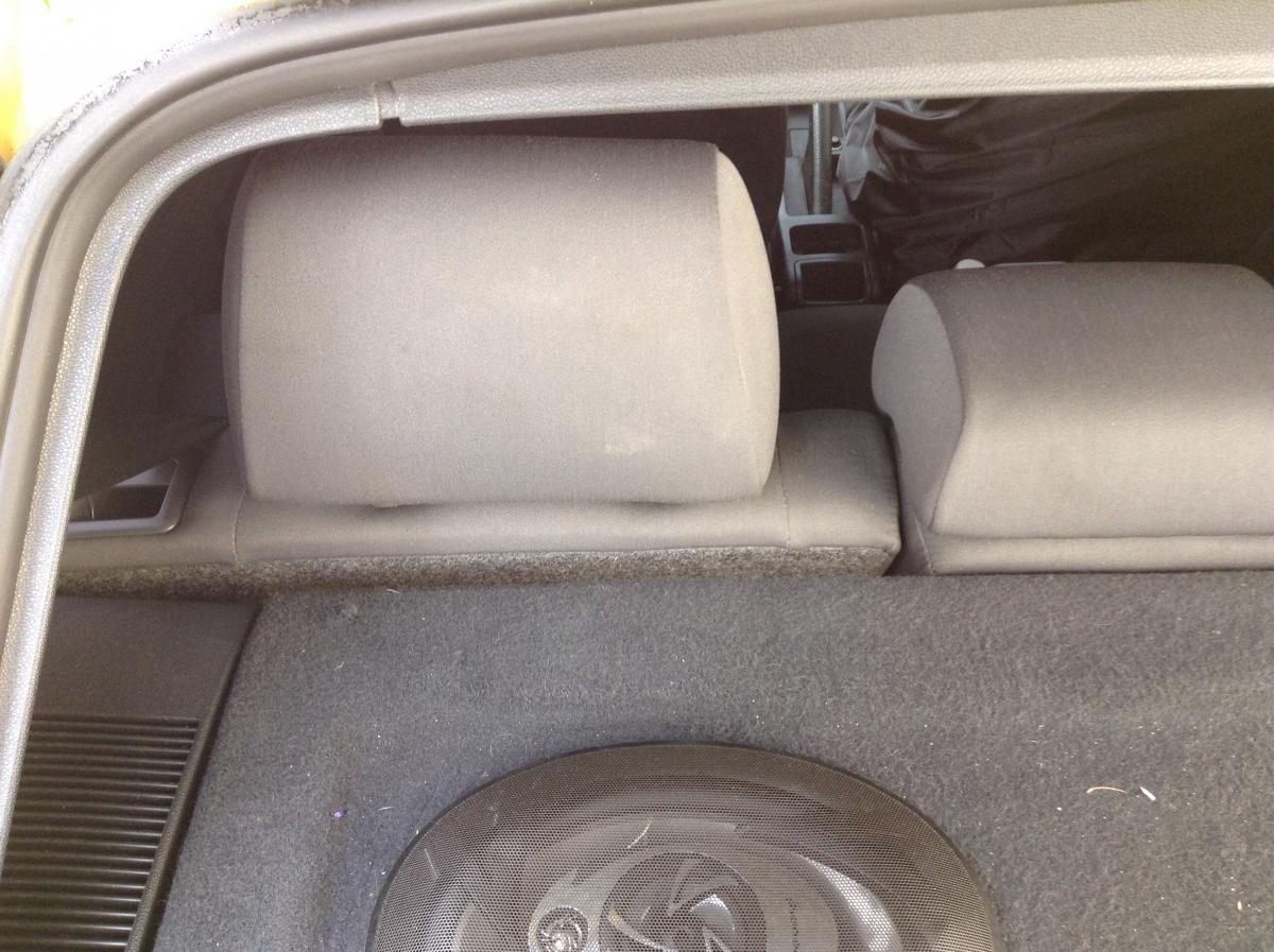

Excuse the speakers in the parcel shelf (last owner thought it was cool )

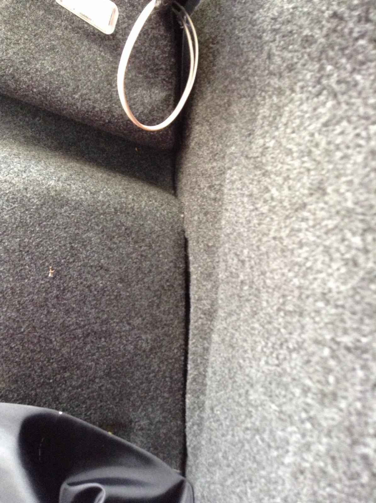

The gap
Hmm that's strange!
On another not you have a rare 3rd rear headrest!
Yes very odd I'm thinking that dent is a sign of damage meaning it doesn't fit correctly ?
Yeah does look damaged Tbh. Maybe something heavy in the boot and an emergency stop/bump? Would have to be real heavy though to bend that I suspect.
If you take that section out and lay it on the floor, is it obviously bent then? Might be worth taking the foam and cover off and trying to straighten out the metal if so.
