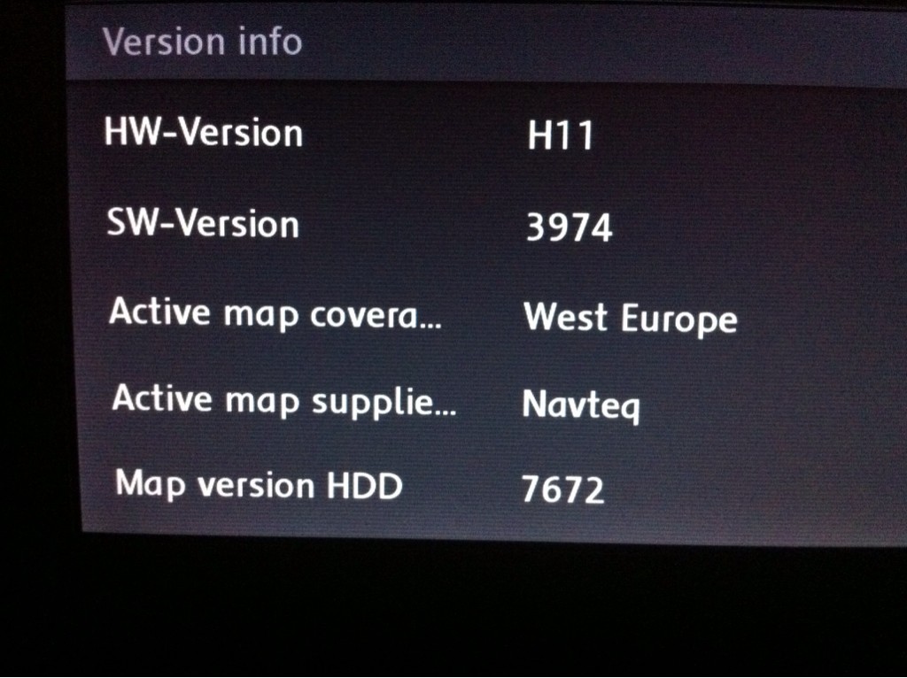

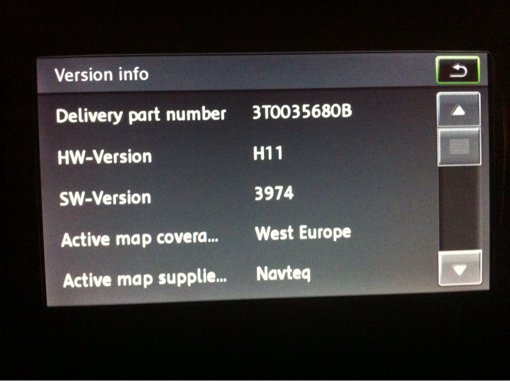

I searched for this here and found one topic relating to a Bolero unit but as it finally worked there was no follow up only a comment that there may be a software update to resolve it so I've posted my unit's details below. Any help appreciated.
