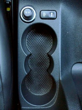

You can disable interior monitoring by pressing the switch which is low down on the centre pillar beside the driver's seat. Switch off the ignition, open the driver's down, press the switch and then remote lock the doors within 30 seconds.

Thanks - not quite with the sequence (bit thick) - so this switch ? which ?
On the door pillar...
Sorry, lost me
Sorry, lost me
Sit in drivers seat, put right hand where seatbelt appears from plastic panel and follow straight down and you will see an illuminated switch. Press it before you get out and lock car.
There is a diagram in the Owner's Manual showing the switch position, albeit for a LHD car. With all the advice here, you should be able to locate it now on a RHD car.
Thanks !  I just thought that was a light, not a lighted switch.  Apologies for being a thicko !
