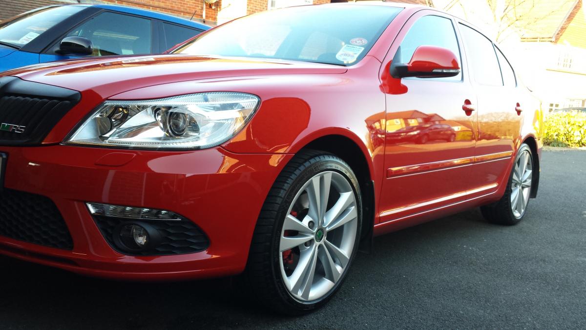

Octavia 8 Hour Detail
Washed with Megs Extreme wash
Dried
De-tarred with TARDIS
ReWashed
Clayed with Megs clay
Washed
Dried
DA with Scholl S17+ and medium Pad
DA with Menzerna Power Finish and Soft Pad
Finish with HD Wax
Megs Endurance Tyre Gel on Tyres
Megs glass cleaner on glass.
Interior is on the hit list next weekend!

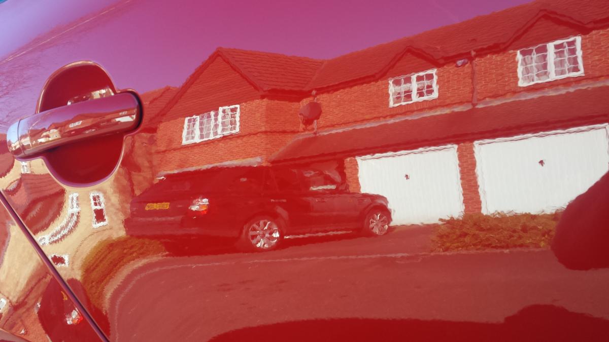

Close up reflection pic is after S17+ before the menzerna and wax went on.
Not bad for nearly 4 years old and 55k ;)
