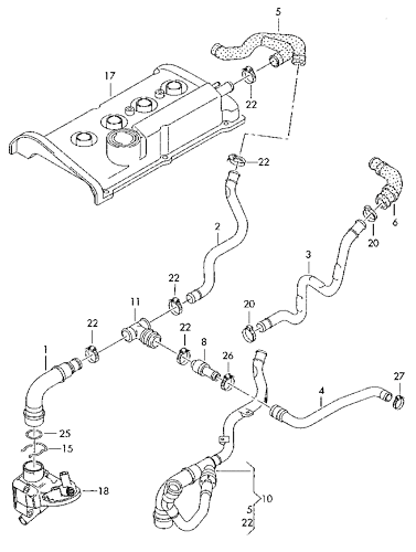

I have a split lower breather pipe and have received the replacement from CM, is there any guide on the replacement? I tried to look for one but couldn't find any. Also can I use the car while the pipe is broken?
Thanks in advance !
Part No. 2 from the diagram
Very easy to do. Just remove the metal bracket from the front of the inlet manifold for access. Does your new pipe replace part 11 as well? It might be worth replacing part 4 while you're there as well.
