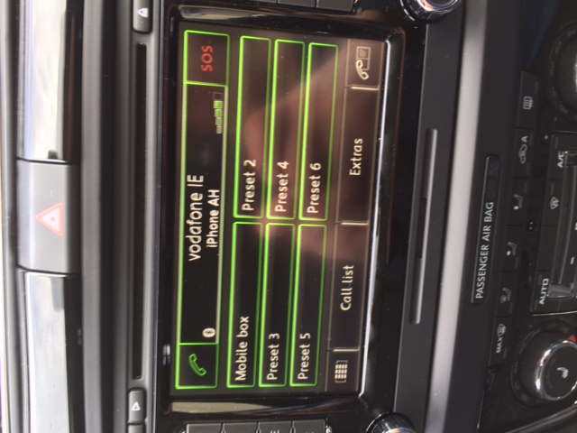

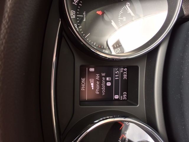

Have   5 days old Superb L&K with a novero HT5 (3C8 035 730 D) module. I am able to connect the IPhone 5S to the car and even stream music from Spotify. However, the user manual mentions the ability to read sms and activate WiFi (by pairing the phone with Columbus). Unfortunately, this menu seems to be locked for me either due to  my ignorance or limitations of the system. I managed to chose Premium from the phone menu and I thought that would resolve the problem, but unfortunately, this did not happen. Does iphone support the rSAP protocol?post-39044-0-11626400-1399833791_thumb.jpgpost-39044-0-28769700-1399833792_thumb.jpg
The menu on the screen on Columbus seems to be missing a few buttons

No iphones will only connect via the "handsfree" option and won't support the advanced features you highlight.  You can stream though.
It's Apple's limitation on the functionality I am afraid.
