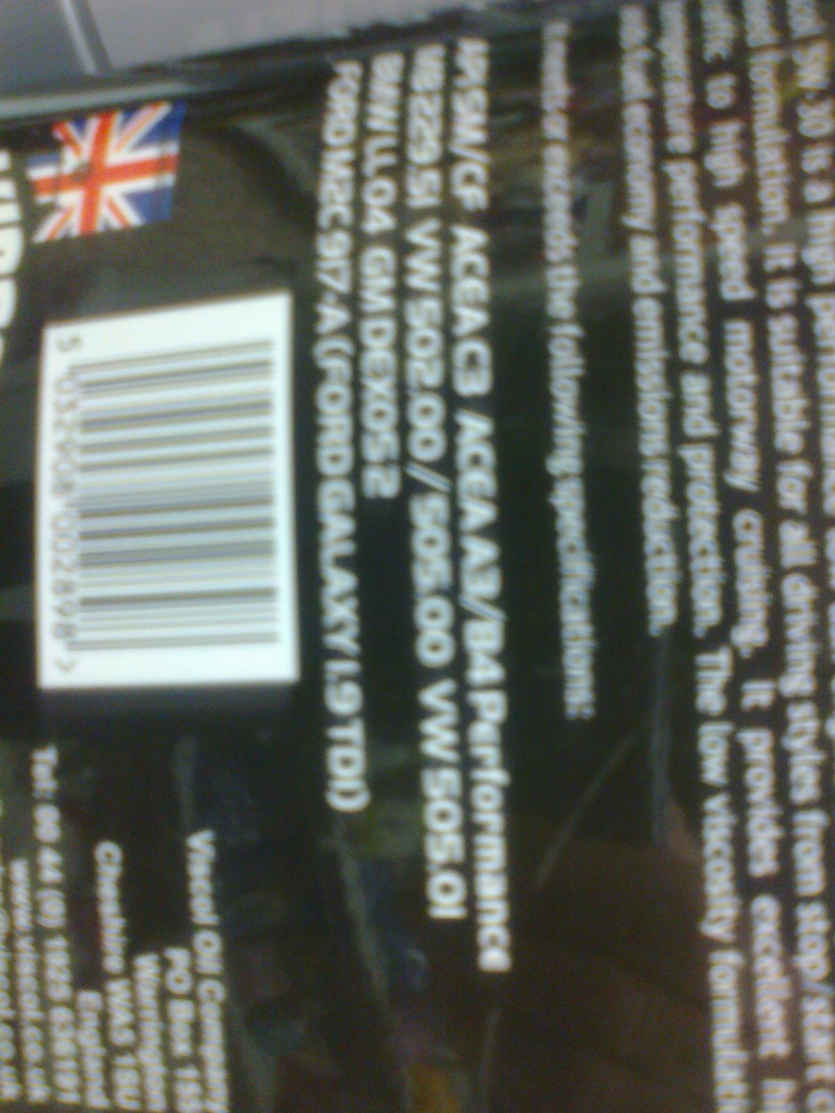

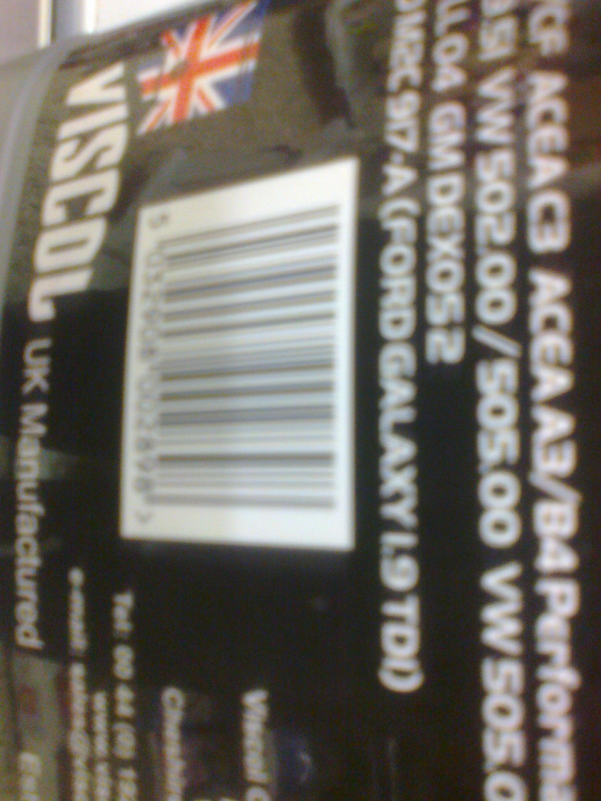

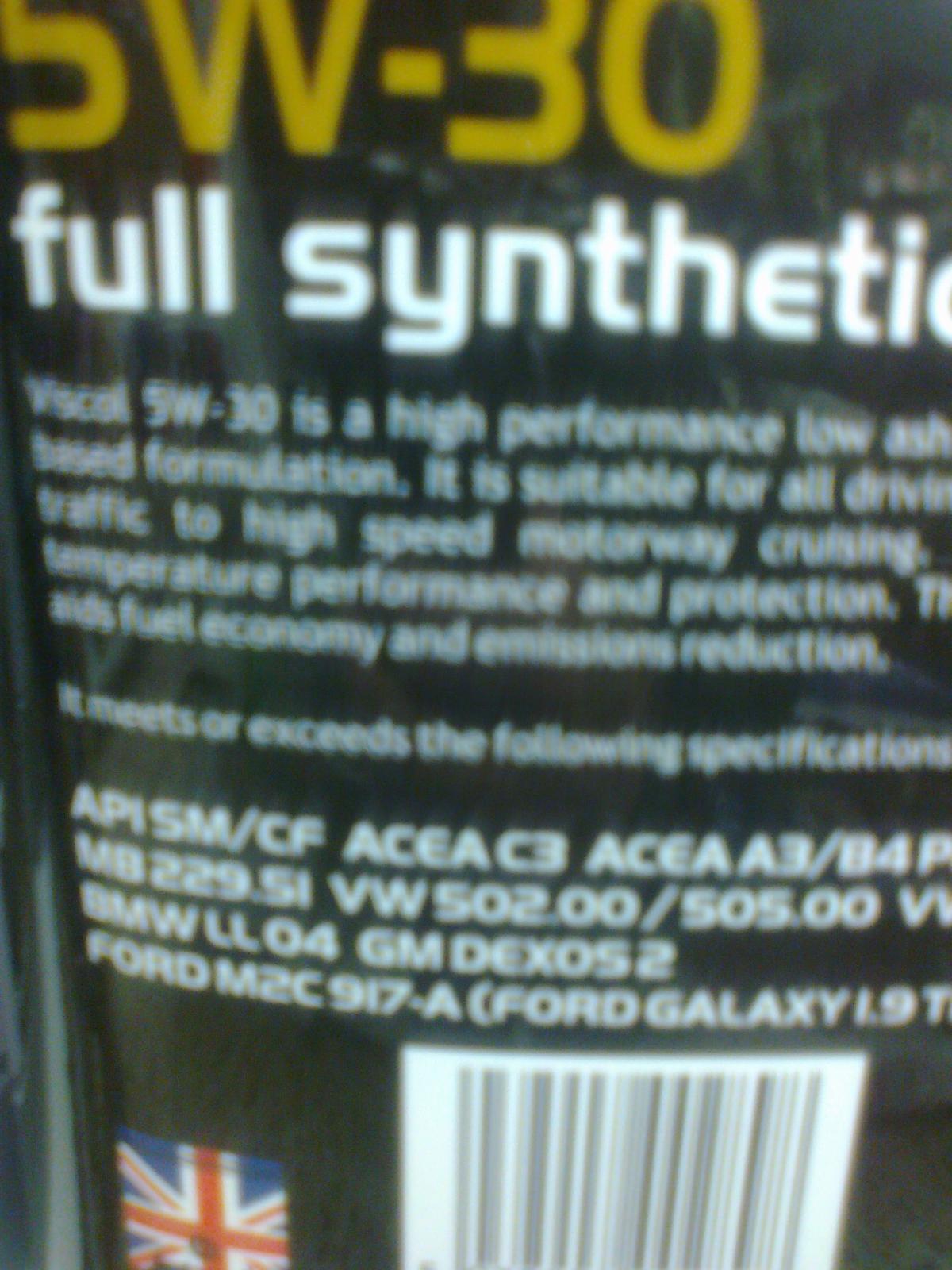

post-35847-0-33784800-1400792033_thumb.jpgpost-35847-0-55394500-1400792115_thumb.jpgpost-35847-0-54846200-1400792175_thumb.jpgpost-35847-0-65195900-1400792227_thumb.jpg
this one
 VISCOL OILS WARRINGTON    They look to be reputable ?

It says 505.01, so on paper it is ok for a 1.9PD.
Thanks Brooke
4.5 ltrs for £12 for oil that 'meets or exceeds' the required standard means it's not actually been tested to the correct standard, but the base stock has at some stage before additives and packaging. It's costing you £0.0025 a mile for 5l of genuine 507 certified oil of a higher grade from VAG's own oil brand, your option is £0.0012 per mile. Personally I'd go genuine, but you can put what you like in :)
