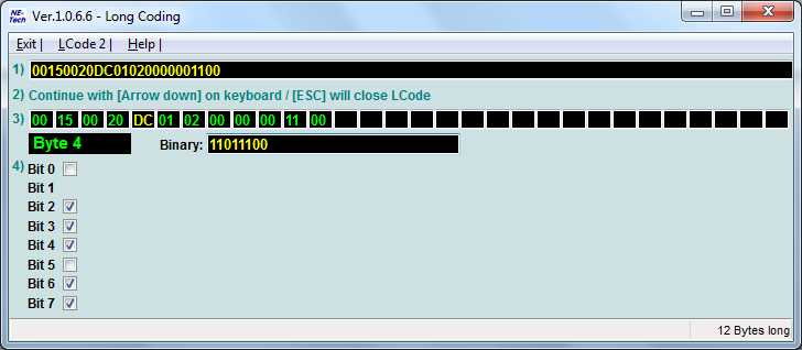

I need help please.
I have recently got VCDS and have been getting on with it fine, however when i was applying the mirror dip on selecting reverse i think i have changed the wrong bytes, i was supposed to change byte 4 enabling bit 2 and 3 however i think i have enabled bit 2 and 3 on one of the other twelve bytes, i did change byte 4 but i am almost certain i changed one of the others also.
This has caused the window to only open 1 cm at a time no matter how long you hold the down switch on for it only goes a cm at a time, you have to release it and then press it again a number of times for it to go all the way down.
If possible could someone have a look at there car and and tell me for the each twelve bytes what bits are selected on each.
starting with the 00.
e.g.
Byte 0 (which is shown as 00 in the above picture)
bits 1, 5
Byte 1
bits 2, 6
and so on.
This would be greatly appreciated and shouldn't take more than 10 minutes.
I really don't want to have to go through each one enabling and disabling every byte, closing VCDS testing it would take a whole day.
Massive thank you in advance.

Have you got a saved scan? The original coding will be shown on that.
i have VCDS 12.12.2 and also the beta version ( beta used for rain closing ) i haven't got a scan saved, i should have done wouldn't be in this silly situation otherwise.
Have look in the debug folder where you VCDS install is, there is a log file that details every change you made.
Moral of the story - always take an autoscan and save it before you change anything!
Thanks Andy found the original long code so will reset tomorrow. Thanks again and from now on ill make sure i run an autoscan first
