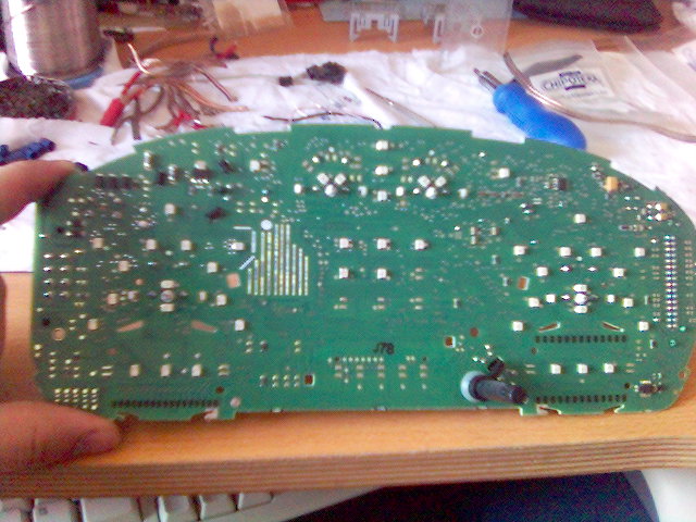

This looks interesting and I like the blue and red dash.
Any chance of an english translation? :D
No problemo! :D
We were actually talking about speaker installation all the time :) This blue/red dash was brought up by skodillac because he saw my thread where I posted a few pics of my blue illumination and he wanted to see how the dash looks now.
Cool.
How hard was it to change the colour?
Did you have to solder new LEDs in place?
You have to replace the LEDs (obviously :)), remove a few resistors and solder new ones in different locations - this is because the original LEDs are connected in series of 4 LEDs and you have to connect new LEDs in series of 2 LEDs, otherwise it won't work (because the blue LEDs have a larger voltage drop that the green LEDs).
Unfortunately I didn't took any photos of new resistor locations but If you can send me a hi-res picture of the dash board I could mark them for you.
