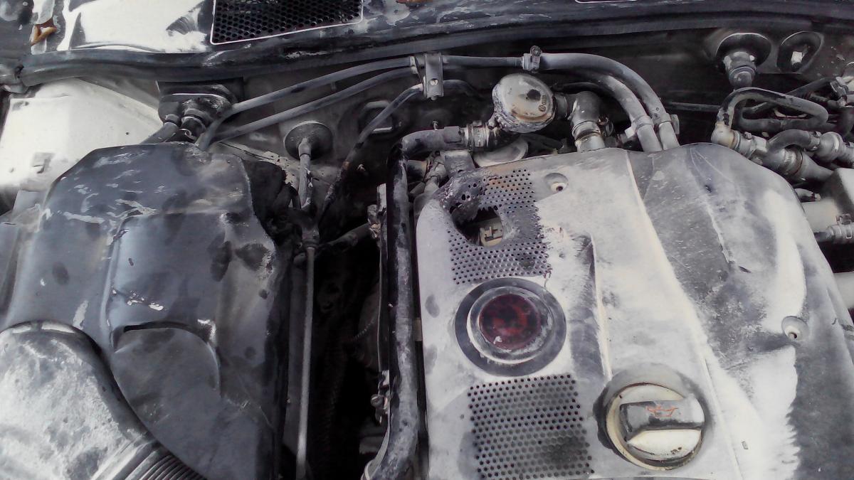

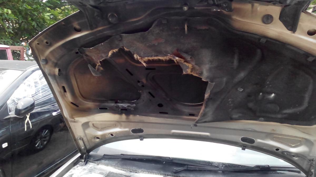

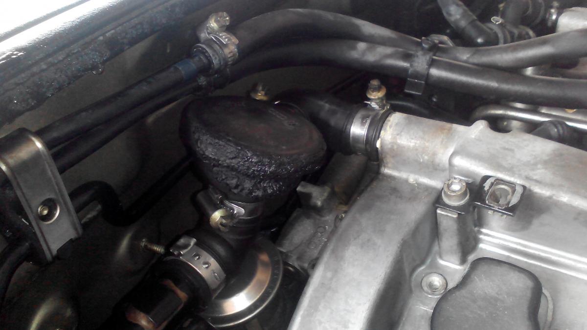

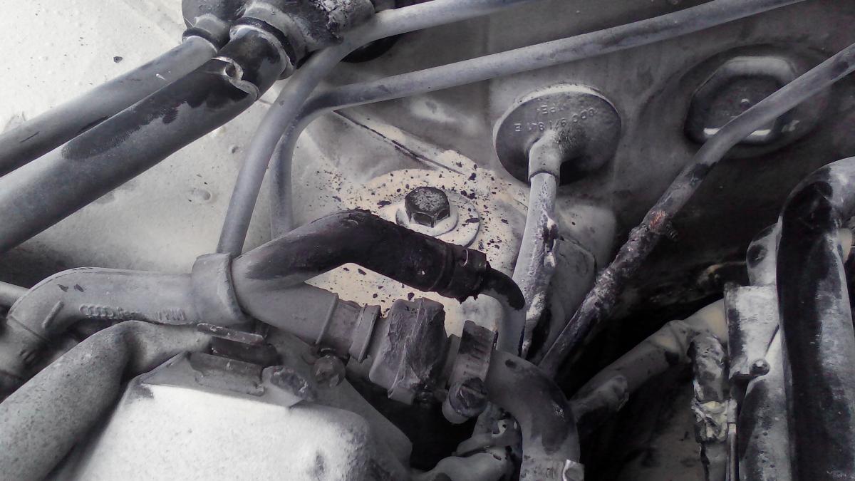

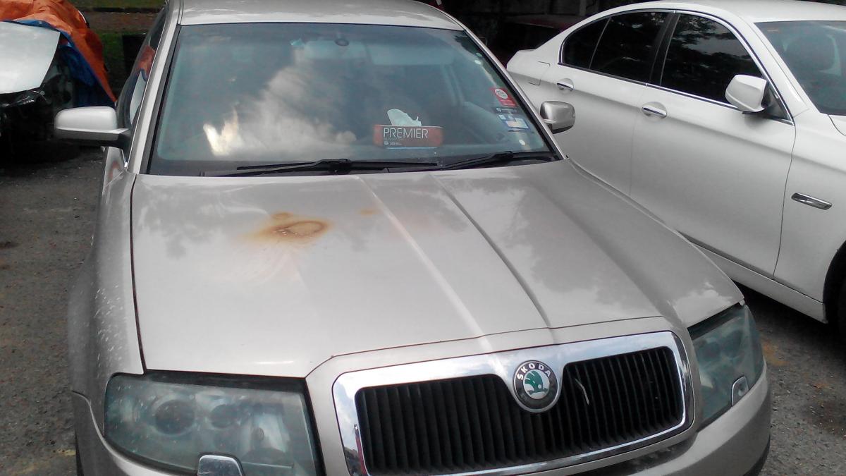

some pictures of what happened to my car
post-117959-0-04364100-1407214875_thumb.jpgburns through the bonnet.need a repaint
post-117959-0-94679700-1407214890_thumb.jpgbiggest fire was from the insulation shield burning away
post-117959-0-89503300-1407214907_thumb.jpgluckily none of the wirings or fuel lines are affected
post-117959-0-36963400-1407214940_thumb.jpgneed to replace this cap

Directly above the fire, you have fuel lines to injectors (photo3). If / when your mechanic decides to start the engine, he should inspect these lines for leaks, especially around the metal clips (cracked rubber there could result in a small leak), or actually given they had been "heat treated" , he should replace them altogether.
I see a lot more parts affected there than just the puck valve, quite a few bits seem to have been overheated, certainly anything plastic/rubber in the area. But it is your car... For me, these pictures once again reinforce my view that diesels are inherently safer.

Still, looking at the aftermath, i cant pinpoint where exactly the fire had originated. the melted rubbers and plastics are not quite localized. one corner of the airfilter cover melted away leaving a strand of wiring few cm's away untouched, yet slightly further away, the rubber grommet (i think it's for the aircond pipings) behind the filter going into the firewall showing signs of melting. then theres the puck valve which is very obviously affected, is some distance from the burnt hole on the engine cover. notice the hole is not right on the edge of the cover, suggesting it wasn't the continuation of the fire from the puck valve. the coil pack under it was saved though.
This to me, looks like the sound insulation that caught the first fire and then pieces of it that's still burning fell off onto these spots, burning away creating the resulted marks.
