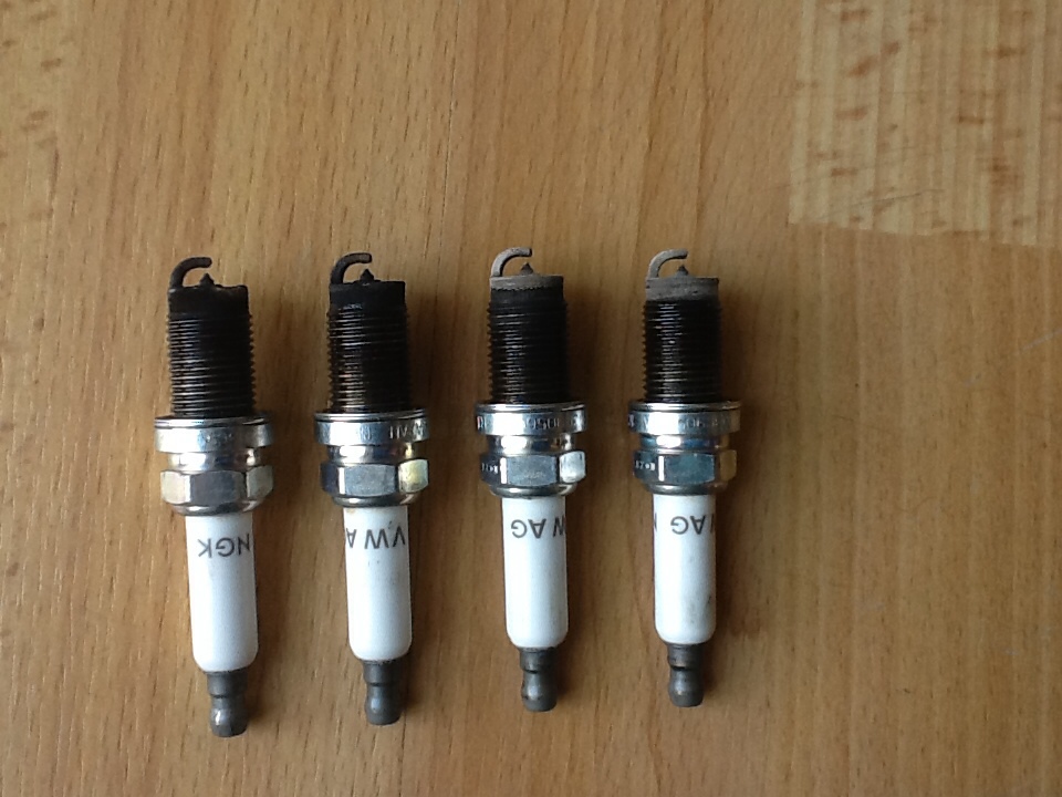

So after recommendations from the forum these are the spark plugs I have replaced from a 2011 fabia vrs with 22980 miles and using 99 Ron from day one just thought I would share a pic of the ones taken out.
Hmmmm - the two on the left look decidedly rich/oily - you might want to refer this to your dealers
Agreed with 2ndskoda, the two on the left don't look too healthy.
They were changed at the right time though for a CAVE,
just in time before one starts to disintegrate at the tip in the next couple of thousand miles.
MrJ.
Had your car had a ECU Update at the first or second annual Service?

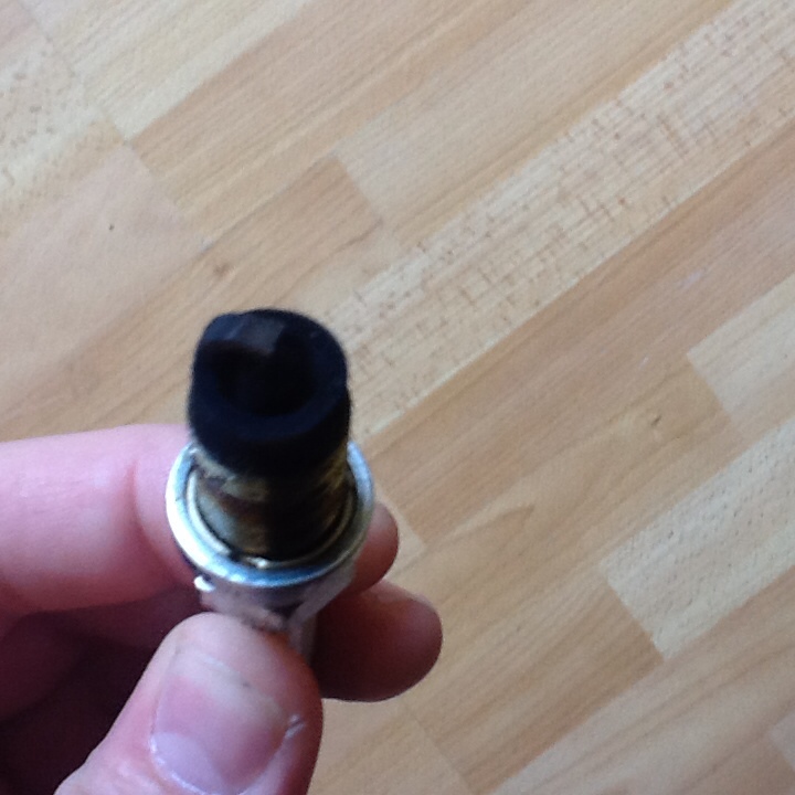

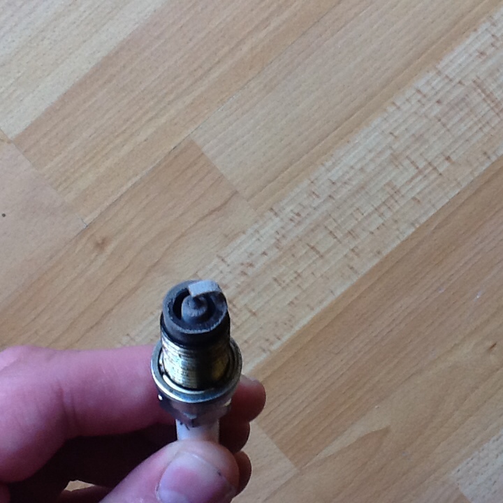

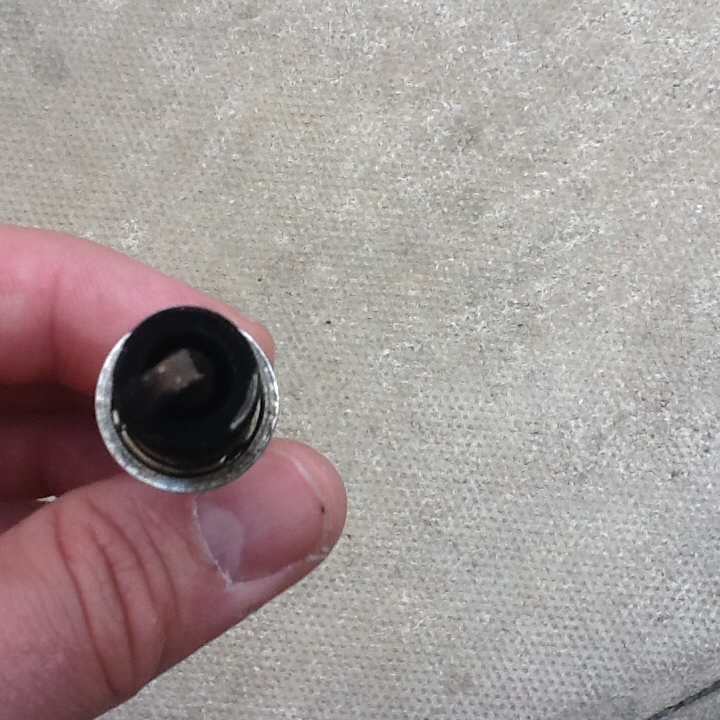

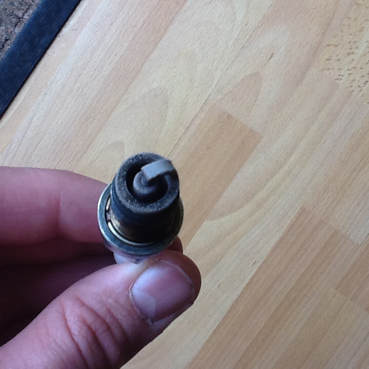

MrJ, are the plugs lined up in order as they were taken out from the engine? Do you have any well lit close up photos "looking into" the plugs one by one?
Sorry for late replies the ecu update was done on the 2nd annual service, at my 3rd service in July I had the gearbox oil changed, I will try and get better lit photos but my phone is shocking quality so I will get someone to assist, as for the order of removal they have been mixed up I should have asked them to place them in order of the cylinder.

Ok so some more photos sorry for some of the quality the plugs are from left to right from the original photo
