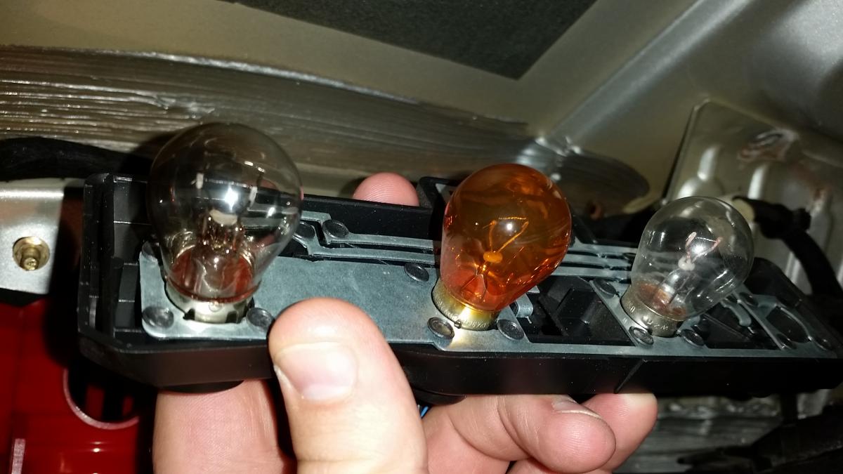

Found out today that neither of my lower brake lights are working except the top LED one
Bulbs are good as is fuse, connections look fine.
Drivers side has a brake light bulb tjat doesbt work located at the bottom

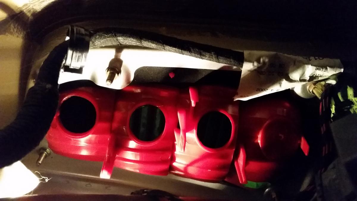

Weird thing is that rear passenger side doesnt actually have a hole for a brake light??
See how there is not anywhere for a brake light to go into lol

The near side does not have a rear fog lamp but there is a hole there for LHD cars. The brake light is in the same place as the tail light.
Switch on your sidelights to identify its location in the light cluster, pull out the light cluster and then remove the sidelight bulb. Check that it is a double filament bulb and then check that both filaments are working using a multimeter on Ohms or another 12V supply. The stoplight and tail light are combined in a singe bulb.

Thought i was missing something! Gonna go back out and have a look
Sorted! New brighter llights now with the braking part lol
