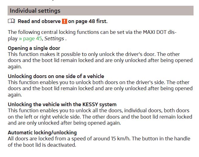

You should be able to set this in the maxidot (see page 45 and 52 in the user guide). Select comfort - central locking. At a guess, you probably want to disable "single door" and "one side" to always unlock everything.

I can confirm that you can do this in the Maxidot :) mine did the same, I now have it open with a single press..
If I remember correct you remove the tick from the either of the first two options in the attached picture...
