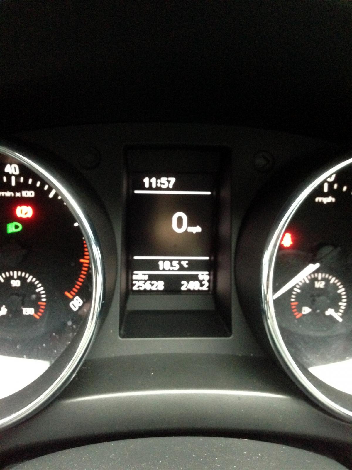

I have just upgraded from a Bolero to a Columbus.
everything works great.
Apart from no sat nav in the maxidot.

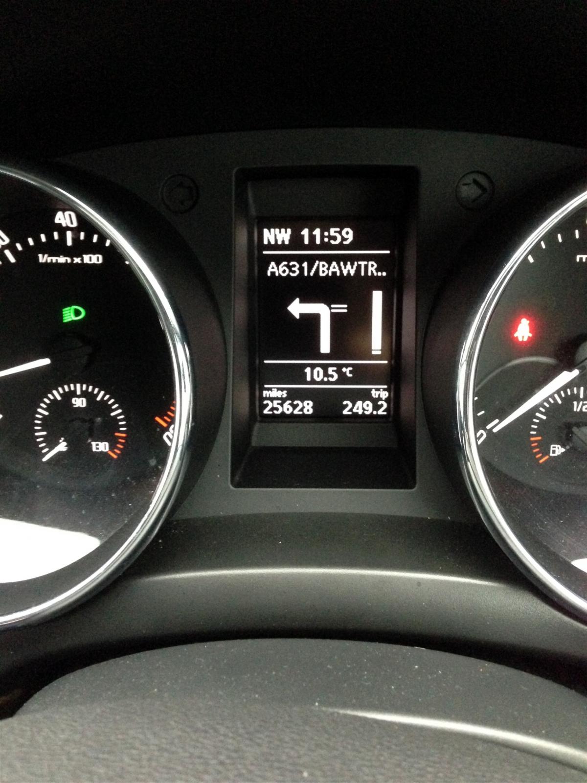

Hi
Latest update.
Found a nice man in west Yorkshire.
Only 28 miles away from me that had VCDS.
Very nice man indeed.
Not only did he do the sat/Nav.
He did the speedo so no more working it out LOL.
He also did a few more thing as well.
A cool trick is the large needles in the clocks when you turn the engine they swing from left to right then back again cool.
Skoda wanted to charge me £80 plus vat just to plug it into the computer LOL.
And they said you cant do it.
well its been done.
It just shows you the people that work for Skoda dealers just don't know anything LOL.
