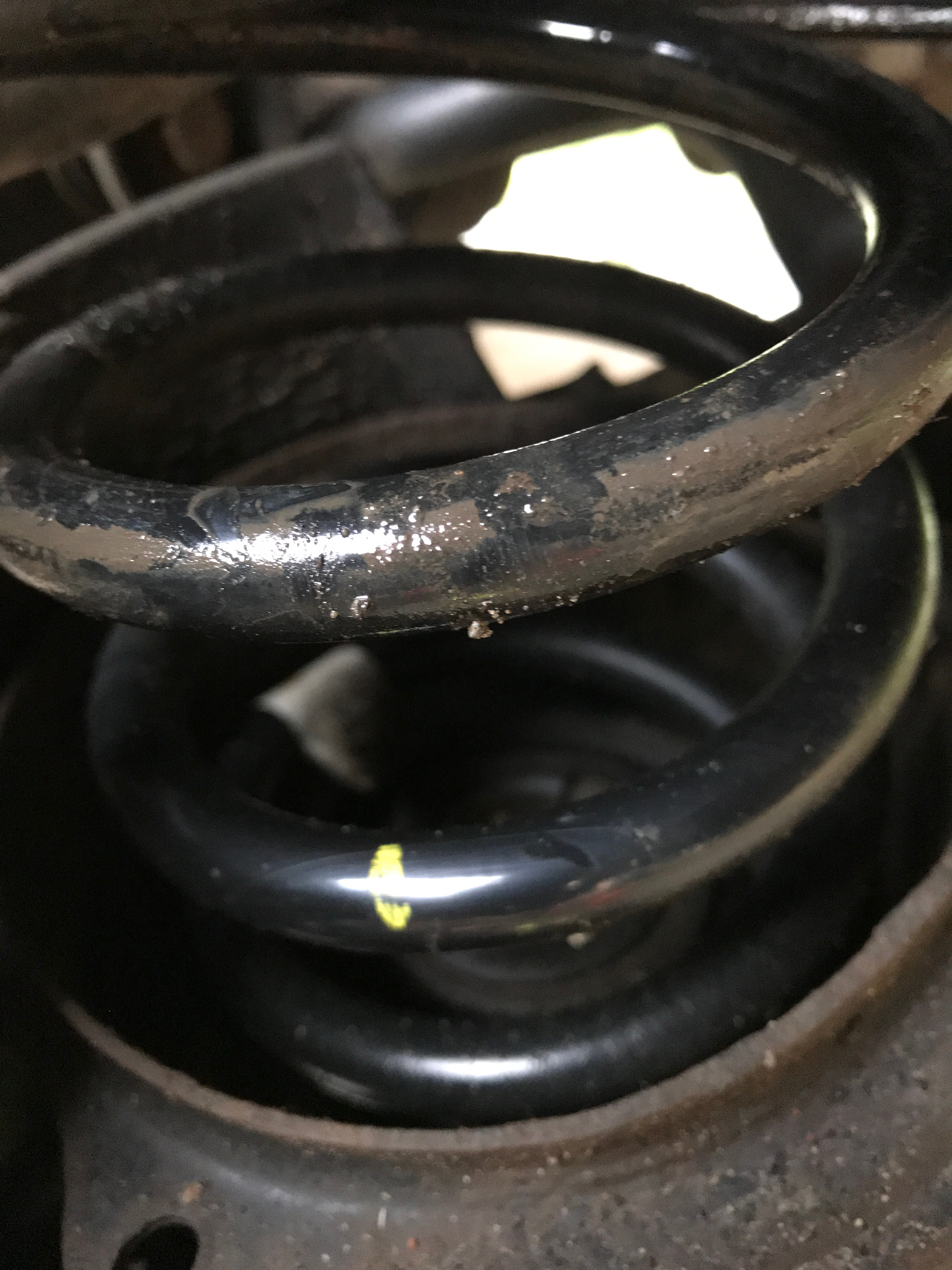

  • To find out what springs were factory fitted, check the build codes or the coloured dots on the springs (if they are original).   For example, if you had build code PR-L30 or 1 grey do
  • Just as an update to my spring replacement last year: all good. Handling is great after 4 wheel alignment, sag has gone, and towing a caravan much improved. Brilliant advice on here as always. I’ll be
  • Long time since no update with my Scout chassis parts, but I ended up replacing all shocks and front springs in October 2023 after a clutch failure (was driven approx 270 000km at the time). Rear spri
Scout shocks and springs are supposed to be stiffer than standard O3 equipment, I tow with mine and have done for several years, and have not noticed any real sag, although over time the clearance has reduced very slightly. Might be an idea to find a VAG independent to get advice on a replacement for the rear that would be suitable.
For example, if you had build code PR-L30 or 1 grey dot and 1 violet dot, that would mean that the front springs have OEM number 5Q0411105HR.
For the front springs, you are looking for a number between L02 and L35.
For the rear springs, you are looking for a number between 1JB+0YB and 1JB+0YE.
Some of the build codes are on a white label attached to the car somewhere in the boot area.

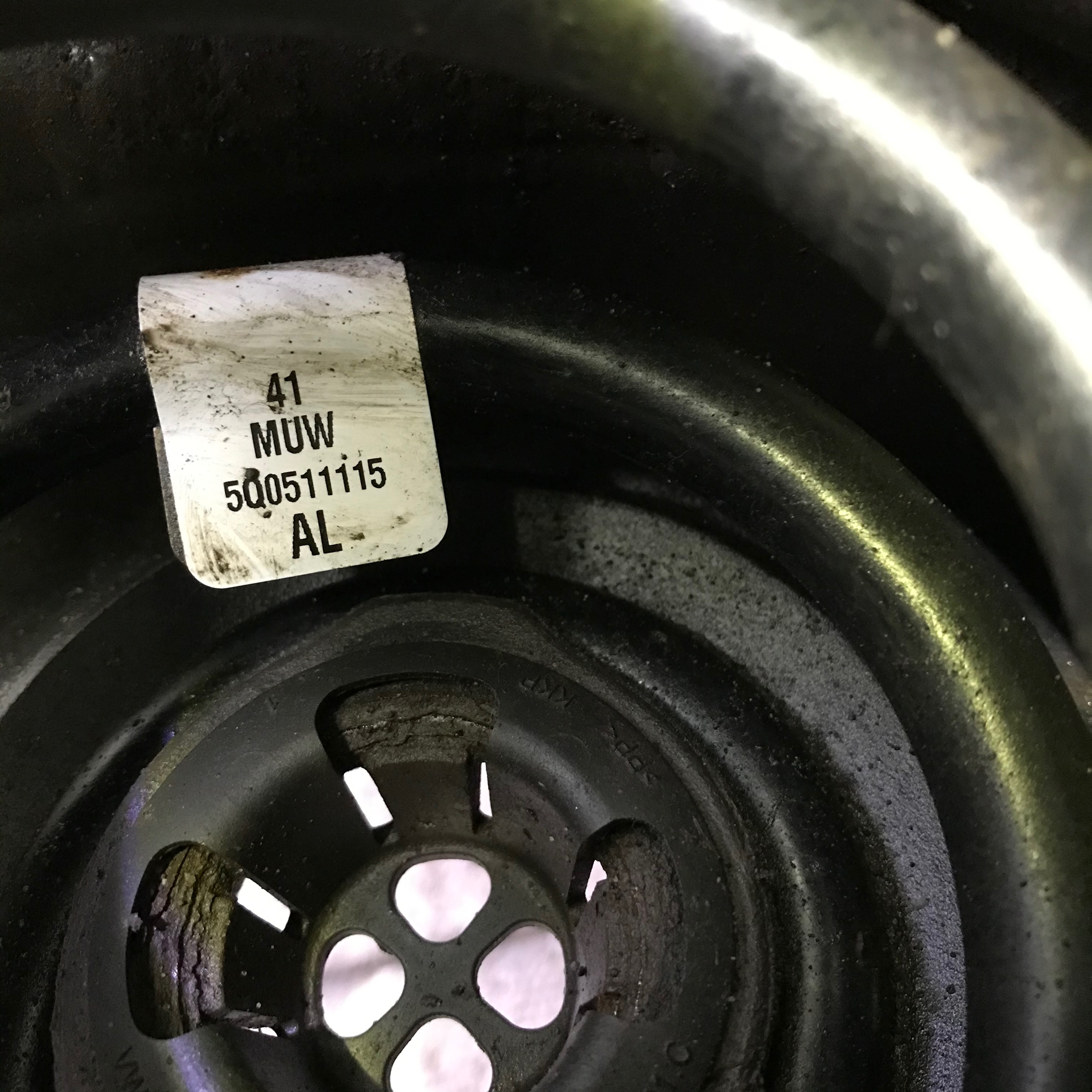

@wallacebob For the rear ones you may need to crawl under the car.. My 16' Scout has no build code for the rear suspension, but only for the front:
G10 = Front shock absorption
L31 = Suspension range 31 installation control only, no requirement forecast
Other codes aren't related at all.

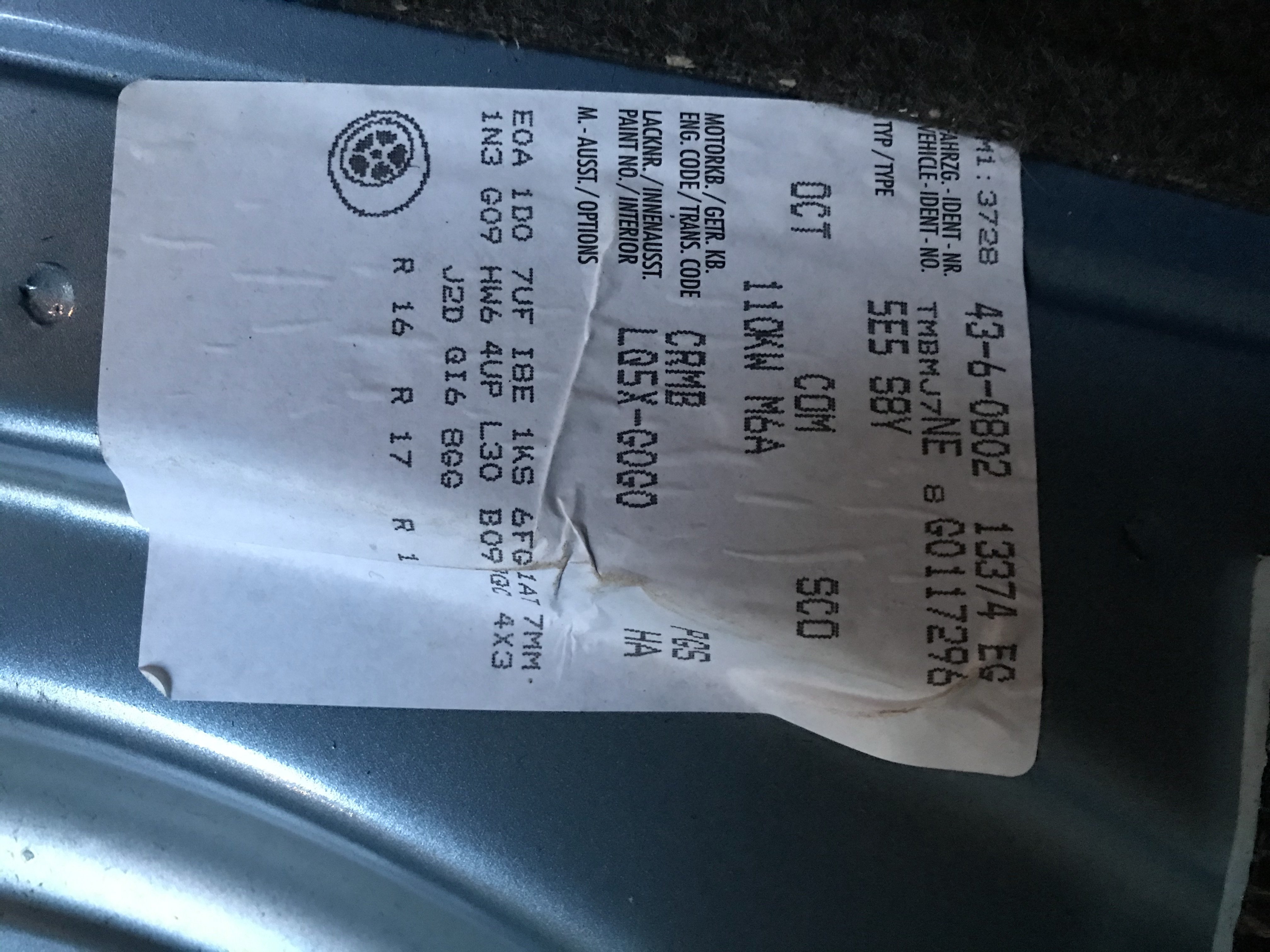

Thanks for the info: it does confuse me! This is the sticker in my boot, where will I find the build codes?
Your suspension codes are: G09 which is general code for front shocks and L30 is for the front suspension range, but nothing is mentioned for the rear. I used the tool provided by @Carlston - http://igorweb.org/equidec.aspx
G09 = Front shock absorption
L30 = Suspension range 30 installation control only, no requirement forecast
Edited by fr1nklyn
Build code G09 means that the front shock absorbers have OEM part number 5Q0413023GB
(8) 5Q0413023GB gas shock absorber 49,6MM
Model data: PR-G09
http://www.oemepc.com/skoda/part_single/catalog/sk/markt/CZ/modell/OCT/year/2016/drive_standart/753/hg_ug/411/subcategory/411002/part_id/2561497/lang/e
Build code L30 means that the front springs have OEM part number 5Q0411105HR

Thanks for useful info, any place I can see parts for rear springs and shocks?
Is your car an Octavia MK3 Estate 2.0TDi 150HP 4x4 Scout with manual gearbox (ie. not DSG)?
Kilen 65073 is sold to replace both the 1K0511115CS rear spring from the Octavia MK2 and the 5Q0511115AM rear spring from the Octavia MK3.
Spidan 86501 is sold to replace 1K0511115CS

I checked spring today, it's 5Q0511115 AL, and 12.5 mm thickness, the softer of the three options. Label still attached. The only colour dot was a single yellow one. So, I may try to get 2 x  AN or equivalent to stiffen things up. Many thanks.
IMG_2476.thumb.jpg.d15a6a1f942db5434d316ce925b4d9b9.jpgIMG_2455.thumb.jpg.346e72194a13ecc2c534c5ede54806fc.jpg
Having the softest of the three different rear springs makes the problem very easy to solve.
You may find that just fitting a new 5Q0511115AL would improve things if the original spring has started to sag, so maybe consider the middle 5Q0511115AM spring, but if you feel that you need more than a small increase in stiffness then the hardest spring would be the one to go for.
I've looked at the actual photos of all three springs on the gknautomotive website, and they all have about 8.5 coil turns and about the same uncompressed length. This makes it easy to do some maths to get a good idea of how much stiffer the medium and hard spring is compared to the softest spring.
The medium spring is about 4% stiffer than the softest spring, and the hardest spring is about 8% stiffer than the softest spring. So maybe your choice of the hardest rear spring would suit you best.
