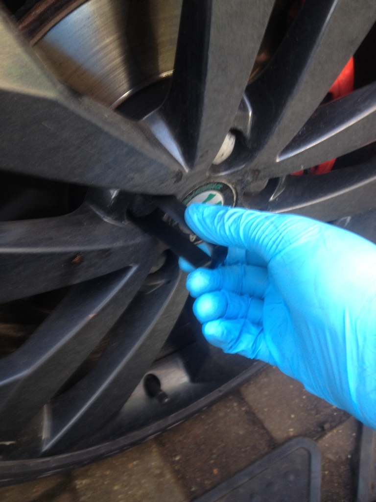

Remove wheel nut covers, then crack the wheel nuts whilst still on ground saves trying to hold wheel still. Its a 17mm head, be careful not to slip on locking wheel nut!

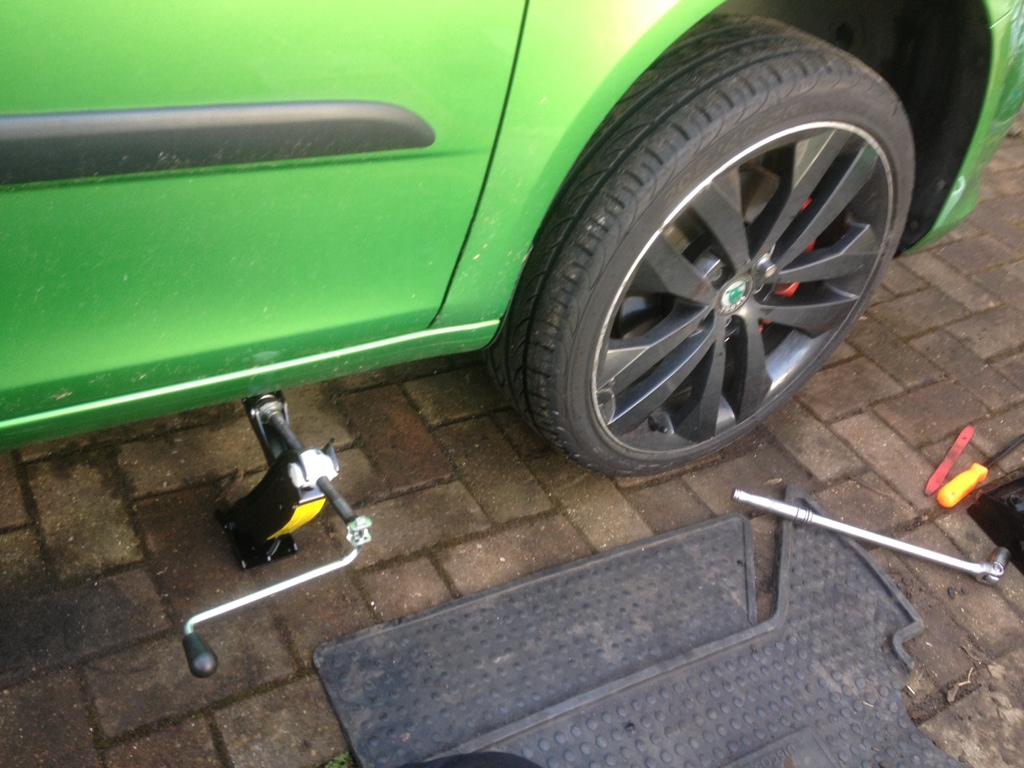

Jack up, you can use the hack from boot or a trolley jack (mine was being used else where) use a axle stand under suspension for saftey. I personally lower it on to axle stand to save seals in trolley jack and to avoid it dropping off the one out the boot.

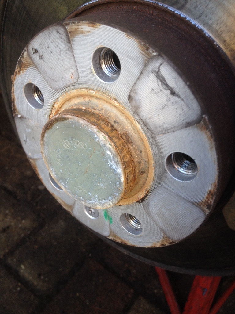

Remove wheel, as is common on VAG vehicles my hubs and alloy had some corrosion so need so gentle persuasion with a lump hammer and bar. I whacked the inside wall of the tire a few times with hammer. Worth leaving a few wheel nuts in half way to save you hitting the alloy and it landing on its face and scuffing up! Once its off worth wire brushing the hub and then putting some copper slip on before wheel goes back on

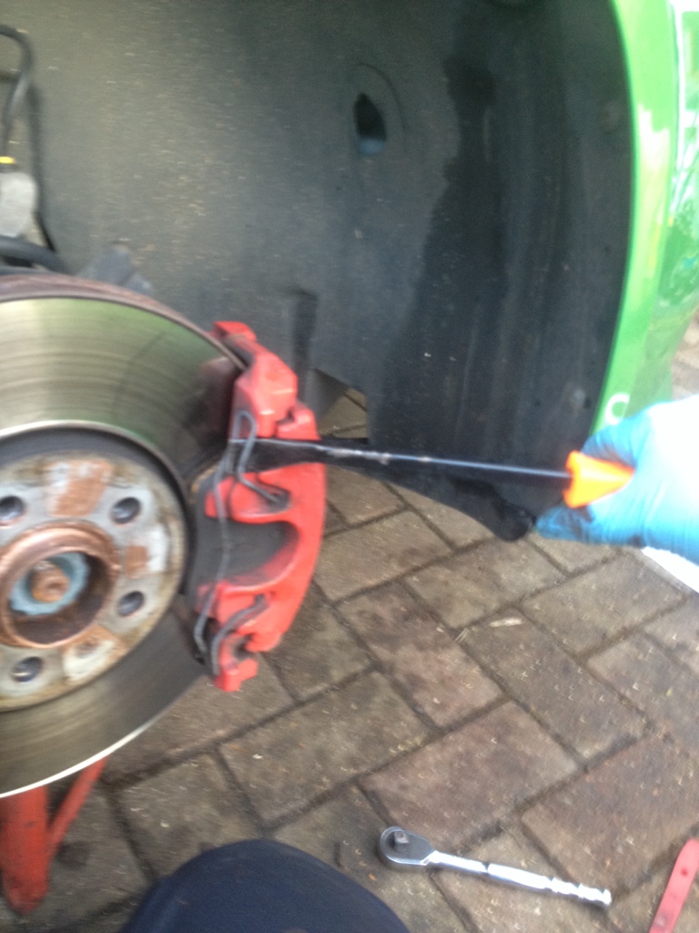

Remove retaining clip some times takes a fair bit of force!

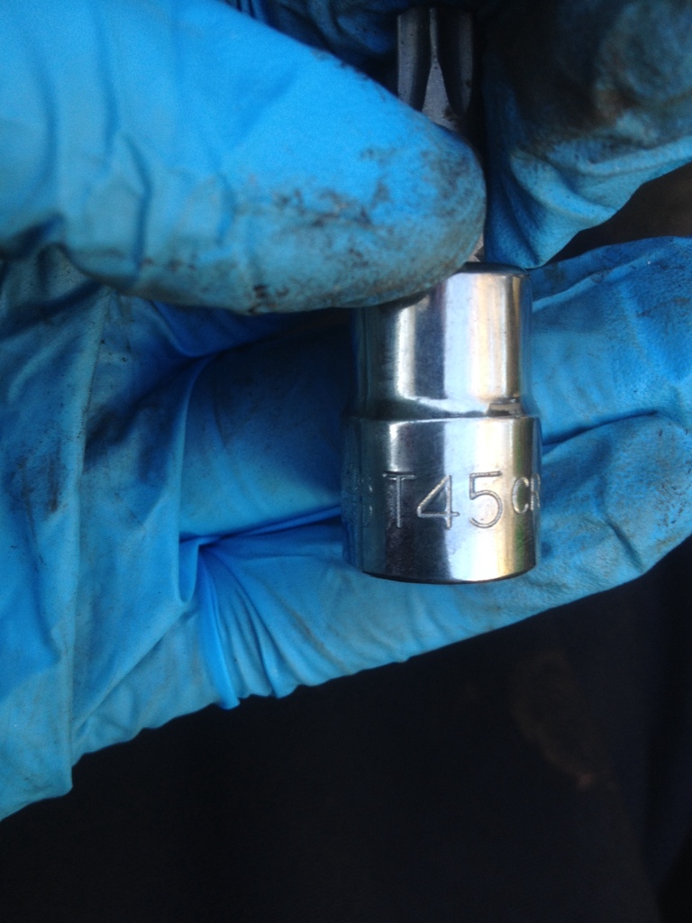

You then need to remove the pin cover to get to the bolt. Its a t45 on the vrs imagine its same on them all

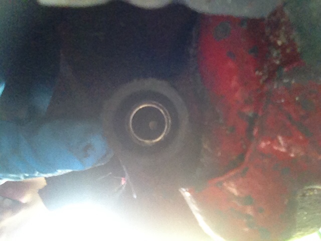

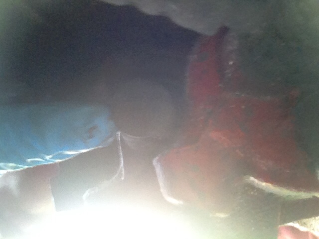

Then undo top and bottom pins. They wont come all the way out normally as the thread isnt long enough to get the head out the cover so you need to wiggle the t45 to get it out if you can if not then try this.....
Wont let me put any more photos up any ideas?
think I've solved it !
https://www.flickr.com/photos/130095237@N05/16355921582/
then the calliper is free to move, be careful not to put any real straight on break lines
https://www.flickr.com/photos/130095237@N05/15734370124/
sometimes to get the calliper off it can be tricky, 2 ways 1) brute force 2) put your hand on the back of the calliper and pull hard towards yourself and this pushes the piston back in allowing you to remove it far more easily.
