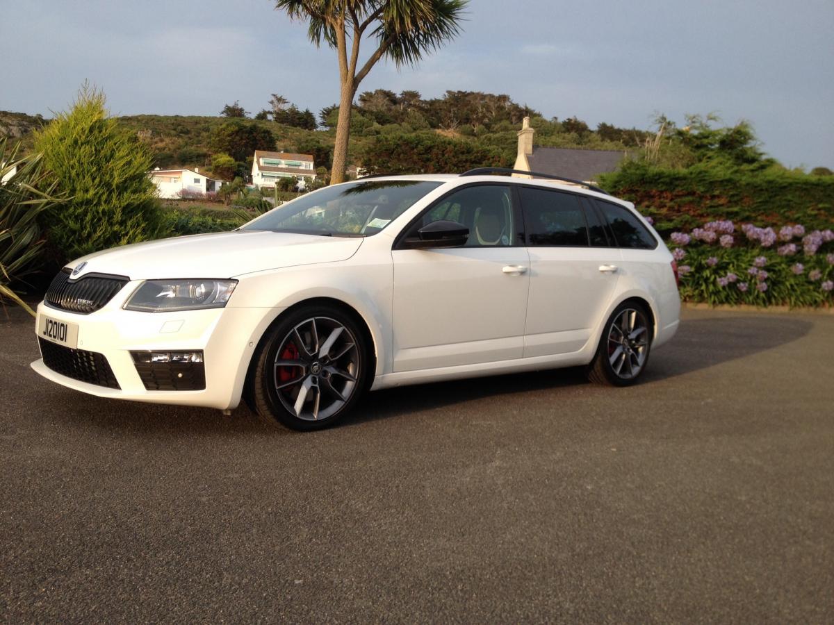

Mine on dealer fitted Eibachs at Simpson Skoda
54055848-3167-4AA3-A9F8-250287A1CC46_zps
C2B340C6-EEC7-465F-892D-0D7C2AC1BFEE_zps
Edited by Moley RUFC
That looks awesome. Gawd I wish we could have gone for the extremes.

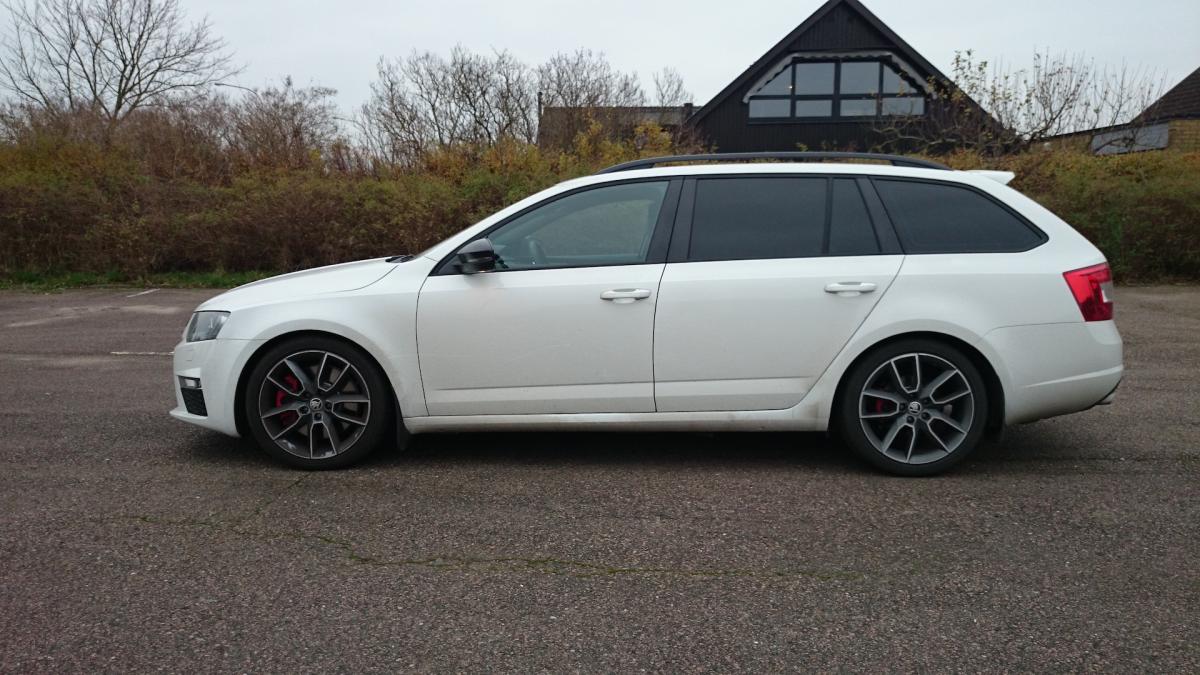

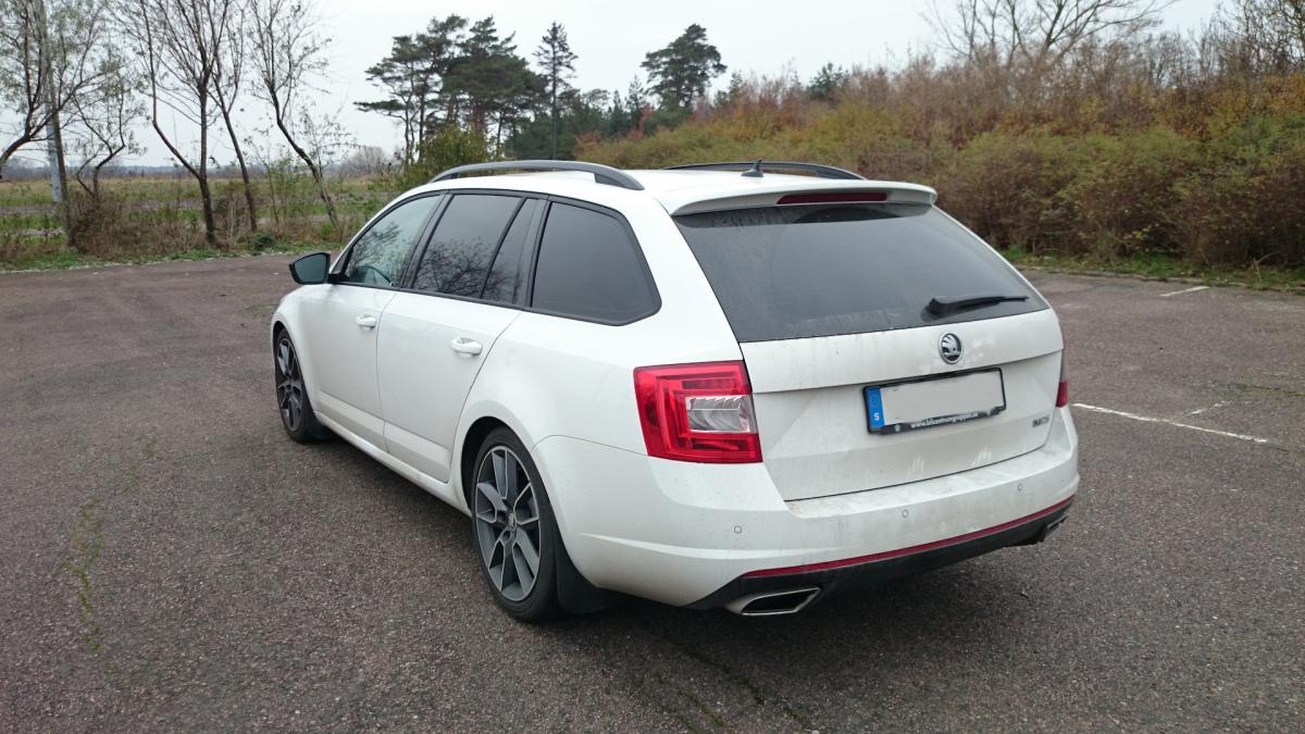

H&R's (-40mm front/rear) on my diesel vRS.
