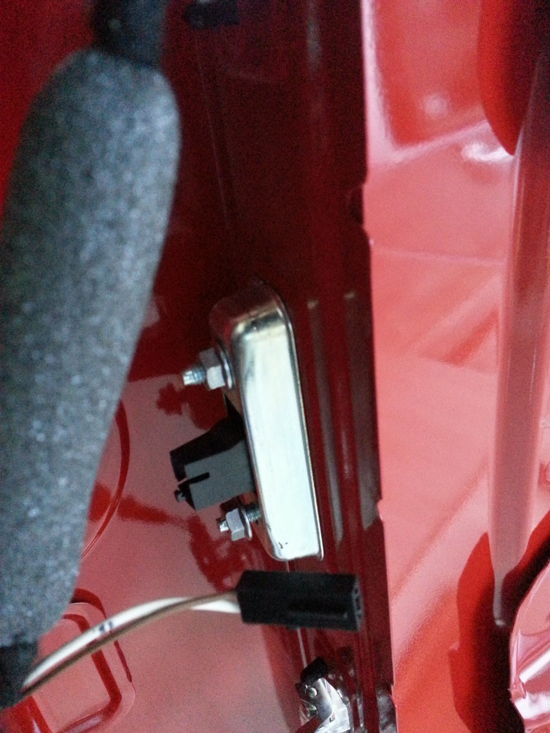

Mounting on the rear door?6_zps72e14298.jpg how do I hide the cable here

Mounting on the rear door? how do I hide the cable here

As BossFox confirms there is an ignition live supply in the rear door so no need to run any wiring back into body, dose'nt get much easier than that!
Front is wired direct to the fusebox.
Rear is wired to the ignition live on the rear wiper, saves running cable trough from the tailgate to the car.

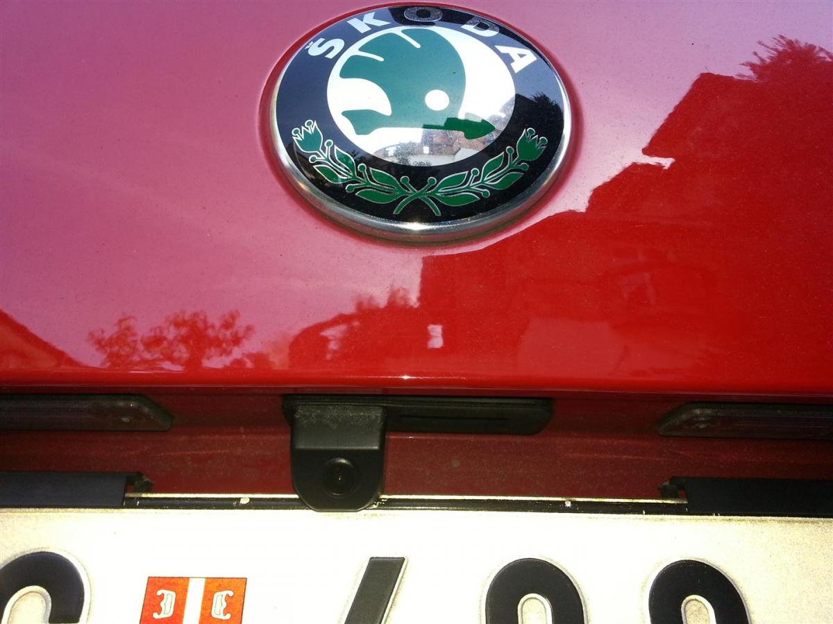

I could recommend rear view camera on picture incorporated with the grab handle of a rear door, I bought one over web site www.aliexpress.com for some 25 euro with delivery, works perfectly for over a year.
