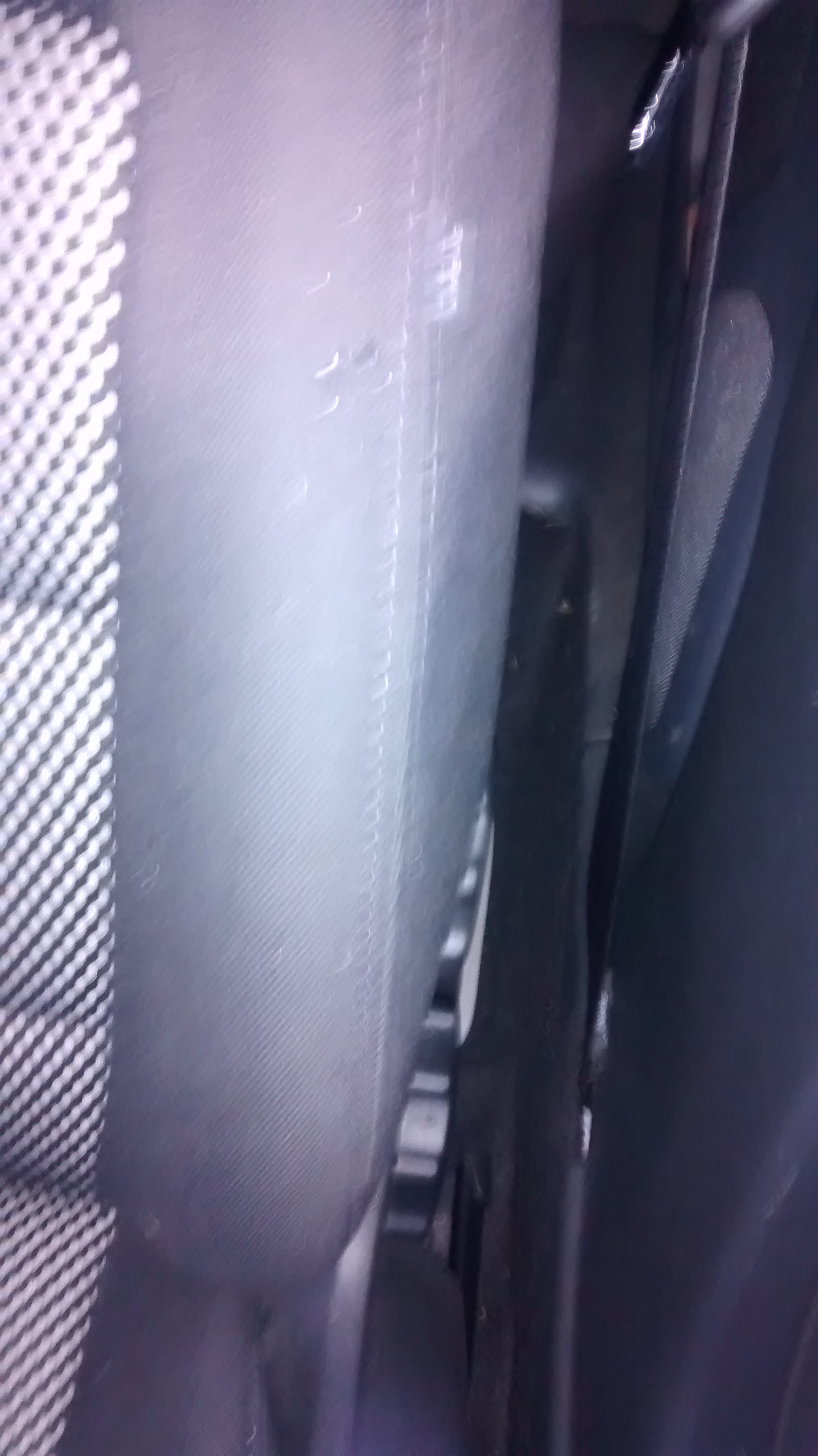

Anybody had issues with their drivers seat and airbag module?
Mine sticks out on drivers side, certainly not right compared to passenger side.

It is hard to tell how bad yours is from the pictures.

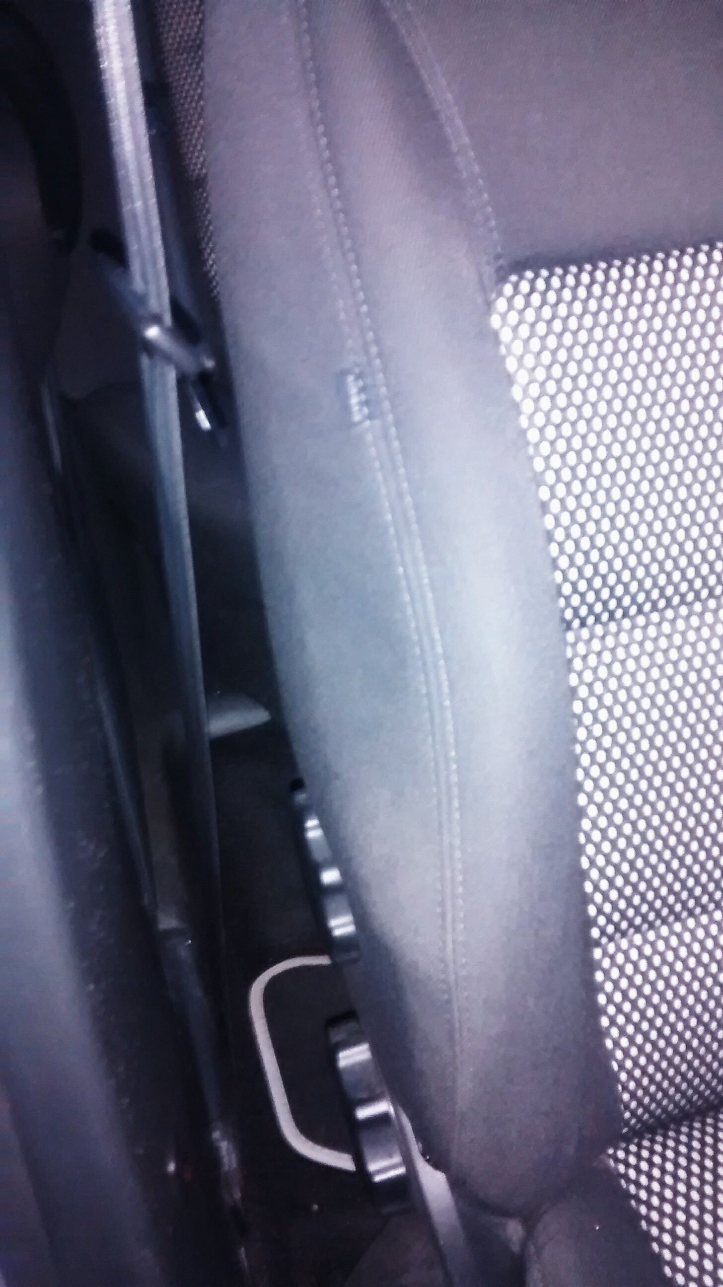

It is hard to see I pictures, but I don't think the passenger side should differ from the drivers side. The passenger side is nice and flat , drivers side you can see the bloody airbag buldging out side, certainly ain't right
I did notice this too on mine, the passenger side is perfect.
The drivers side, although not bulging out, is protruding slightly and is very easy to feel when hoovering the car etc.
