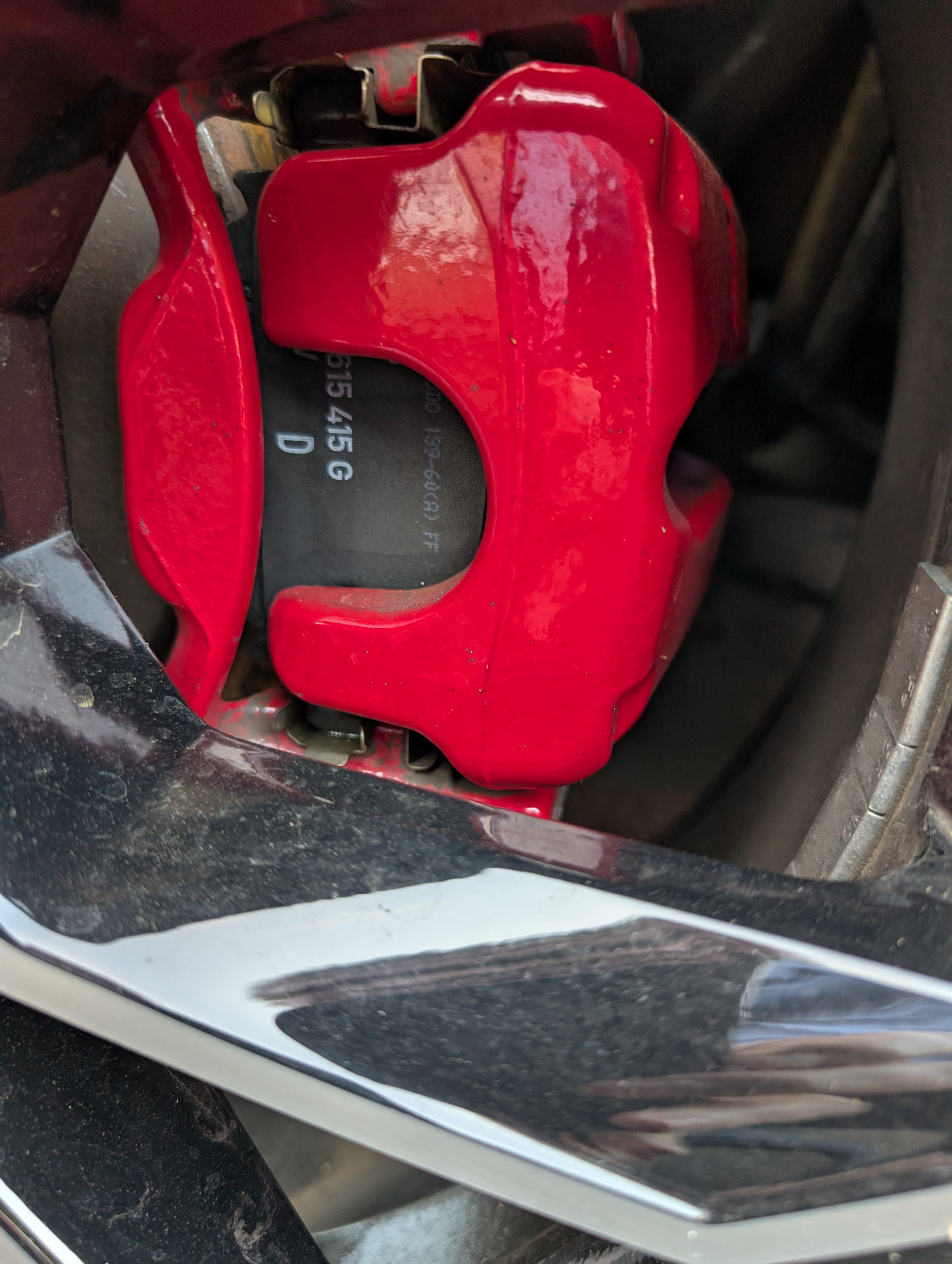

The colour is the same and new caliper matches 5 year old carrier just fine. Here's a photo, not the best lighting but should give you an idea at least.

See my response in your other thread - after accounting for the core return, I'll have paid about £120 each for the official remanufactured calipers by TRW, in the correct colour. The only difference from the Skoda supplied part is the VW logo being ground off!

Assuming you are talking about 310mm diameter rears, have a look at TRW BHS1701E or BHS1702E from Autodoc, depending on which side you need. They are the remanufactured part numbers for the original TRW calipers, painted in the correct shade of red for the vRS. One of my rear calipers refused to rewind so I was already looking at disassembly & overhaul, but as both were flaking paint I decided to swap them as the simplest cure. The paint on the carriers was fine though, so some added expense if yours need attention. I paid about £300 for the pair and am due £60 odd back, if/when I return the originals.

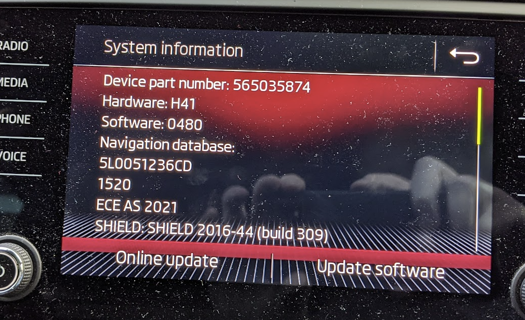

Does 0480 remains the latest version, please? I've had a few issues with Android Auto/Waze dropping (MIB2 screen black or drops to the 'App' home screen) only to reconnect seconds later and I don't recall experiencing it on 0478 or older versions. Of course it could be cable wear issues (though I've tried a few) or phone firmware updates that have added some instability, so curious to know if anyone else has seen the same?- Online Service History - How to

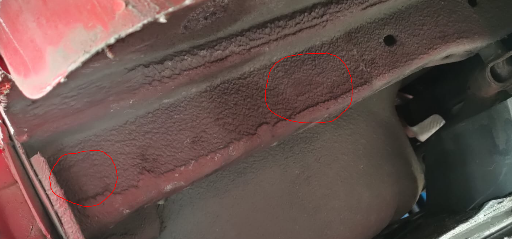

They are hidden by square stickers and covered with the underseal, there are some promising looking patches on your photo. I know they are well hidden, I fitted the OEM bar to my vrs last year.- Amundsen MIB2 Firmware Update

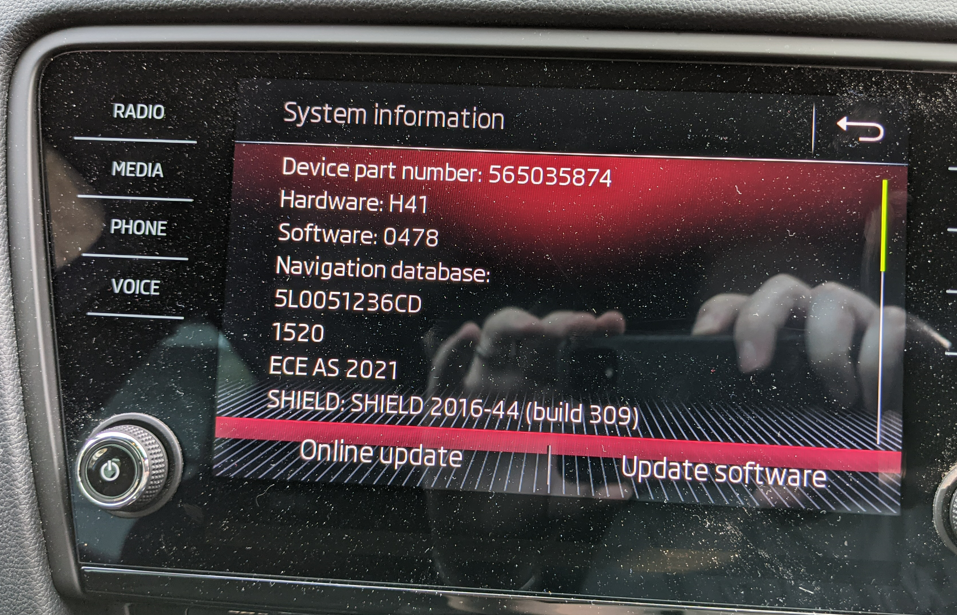

Hello @pab567, I'd be very grateful if you can share the latest firmware for my Amundsen (478?) I've had a couple of occasions where the clock jumps around, I'd like to see if this will fix it.- Towbar Wiring - Removing/getting to rear of fuse panel behind glovebox

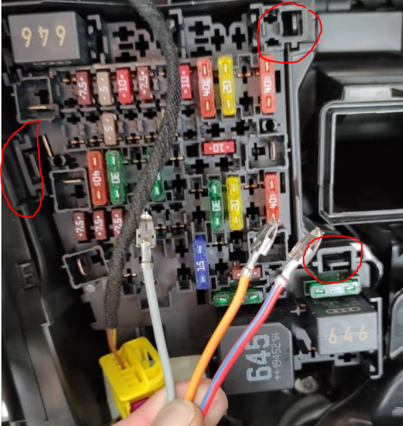

There are several latching clips, circled on your picture. I can't recall if it's 3 or 4 in total. You need to release them all and pull the fusebox forwards. It'll probably be fairly stiff and movement will still be restricted by wires, but lots of gentle wiggling should get it out enough to get a hand behind. Next, remove the purple locking strip from the row you want to add the cables - it pulls out to the left of the fusebox. Finally, easiest method to get a new cable lined up is to put the flat end of a plastic cable tie or similar through from the front, clip the cable over the end of it (just as it grips a fuse blade), then pull the cable tie back through. - ECU update?
