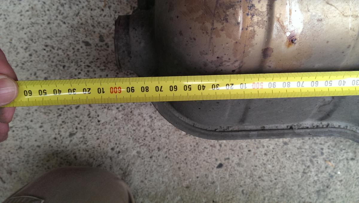

Cam any tell me the dimensions of a standard mk1 octavia vrs backbox box please, pics would be great too
I'm planning on making a straight through pipe for it but don't know the dimensions

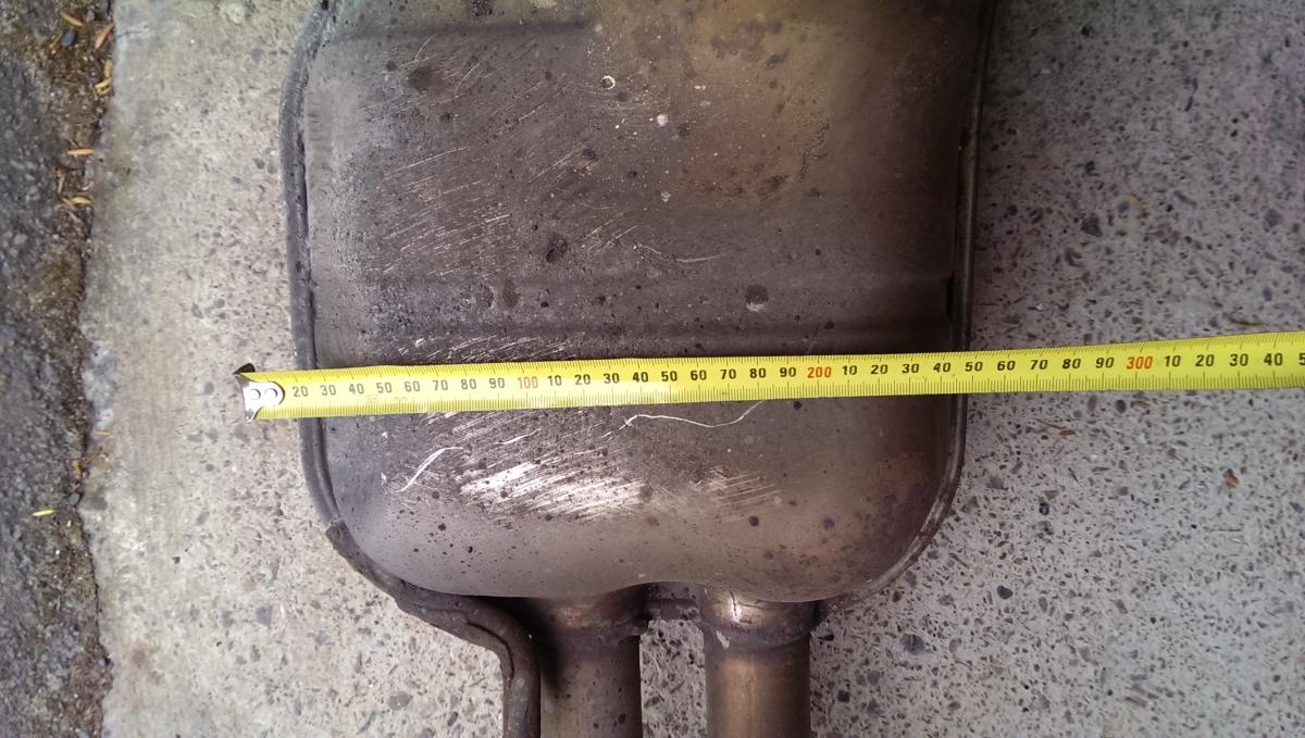

It's huge! And f-ing heavy!
Thanks a lot mate very helpful appreciate it

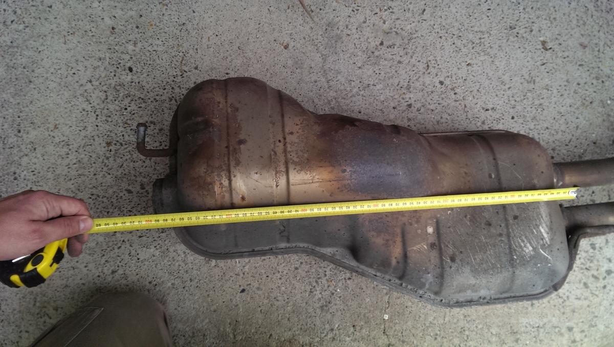

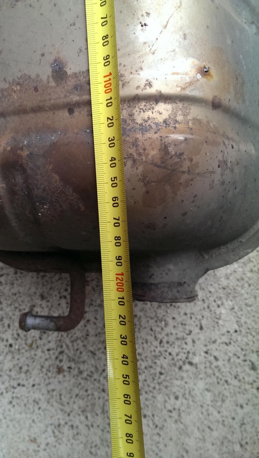

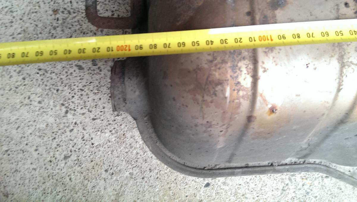

Is that 1200mm long?
Also is that where it separates or have you cut it off there?

Yep 1200mm long. The stock exhaust is one piece and has to be cut off.
There are marks on it where it should be cut but the idiot who fitted my Piper cut it there instead, despite me showing him the marks.

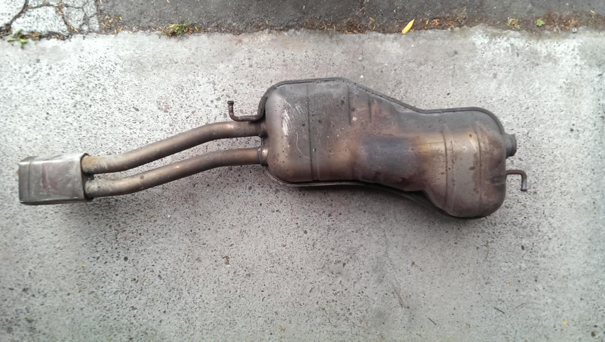

Id imagine it would sound pretty pants with just a single middle box?
Yeah that sounds how I want it
As you can see all he did was remove backbox and extended the pipe and put tailpipe on it. Easy job for an exhaust place
