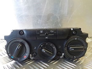

Can the heater controls be changed over has it ever been done?
Has any body tried to fit newer version heater controls are the plugs the same or what need to be changed can this be done easily
Arn't those from different heater systems l/h pic is climate control r/h pic standerd heating system.
Yes mate I just want to no if it's possible and and what else would need to be changed to do so and if it's ever been done
Its been coverd on here befor, and it means major work to heater box if not total replacement due to additional flaps and motors.
