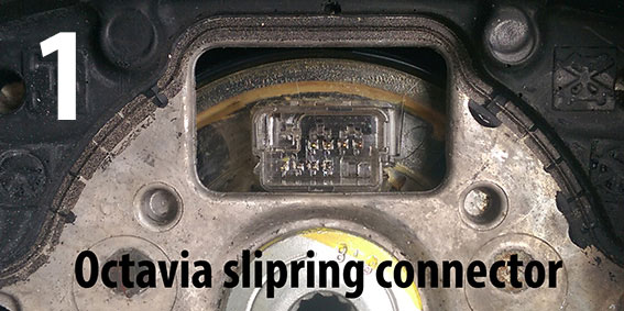

Pic 1
The connector for the octavia slipring, it fits the wheel fine and locating lugs line up perfectly.

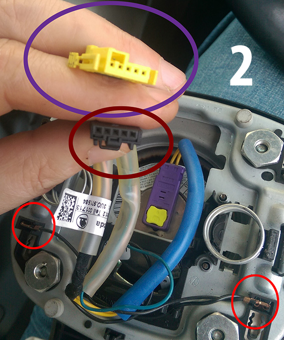

Pic2
The superb airbag to slip ring connector (yellow) and MFSW control plug (black) as you can see its half the size. I have ringed in red the spade type connectors. there are two other wires from the black plug one pink one black

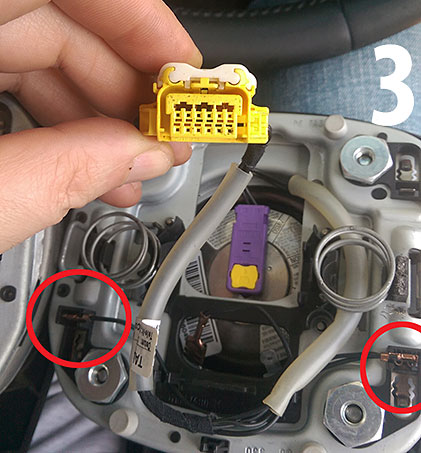

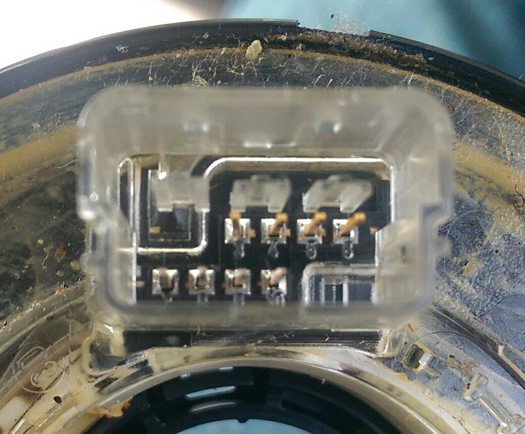

Pic 3
The octavia slip ring connector, as you can see the airbag lacks the MFSW connector. I am guessing as the slip ring  came off a car with the MFSW however the slip ring has the required wiring (the steering angle sensor, steering module also came from the same car)
Attaching the spade connectors is easy enough, my problem is finding out the pin positions for the two what i presume are control wires.

I essentially need to know which of these pins in the slip ring are for the mfsw controls. I have a pink and white wire and a brown wire. Any help at all at this stage would be awesome
