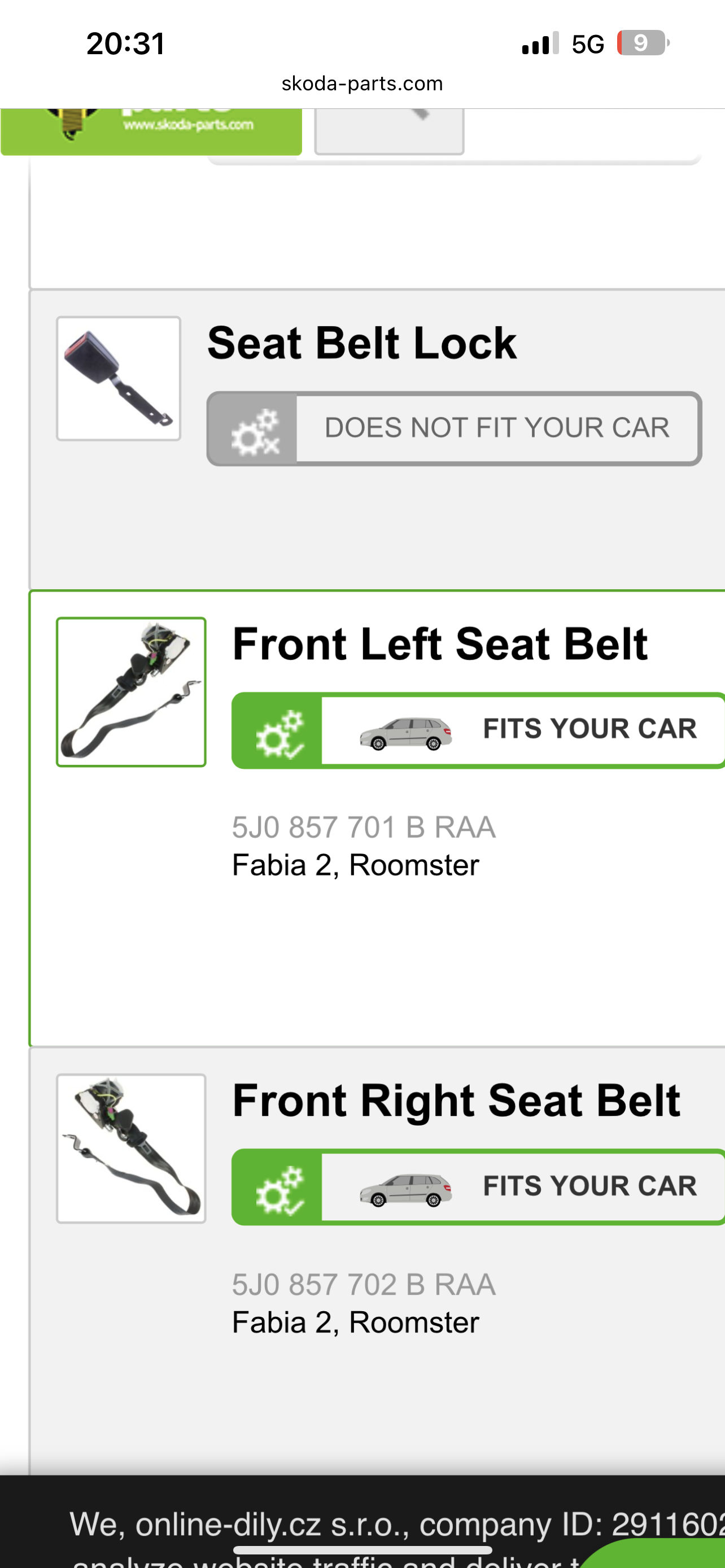

  7. I buy them on www.skoda-parts.com
  8. I’ve posted the link just to let you know which parts are needed, probably if you look for the various part needed on different platforms the final prince would be cheaper
