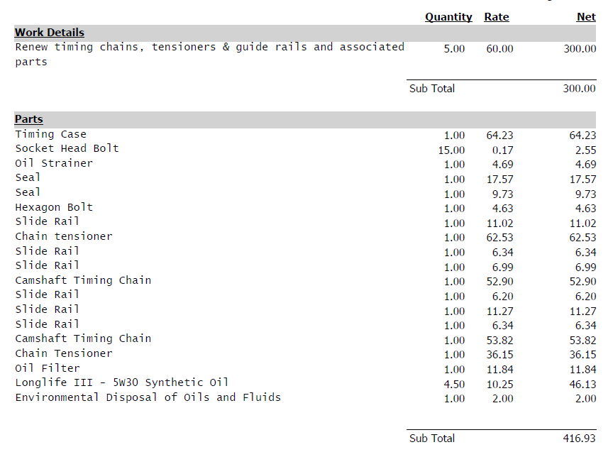

Here are two of the quotes I got, and the only ones to give a breakdown. The first came to £1063.84 after vat:

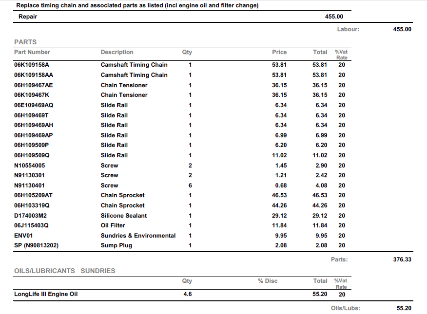

The second came in at £860.33, but for some reason they wrote that they were aware of this issue and 'the' technical bulletin, and it' wasn't the chain and tensioner that are failing but will add just the cost of parts at £70.84 as they'll already be off. Not quite sure what they think is failing in their opinion.
Would be very interested to hear from hanseandy which dealership is offering that with all the guides and everything else changed for £600! The nearest approved repairer/dealer to me is Seat Camberley and they rocked in with the largest quote of £1075 but I would never go there anyway as they were snotty with the ex-wifes seat and there's one turd there who has no idea of customer service.
