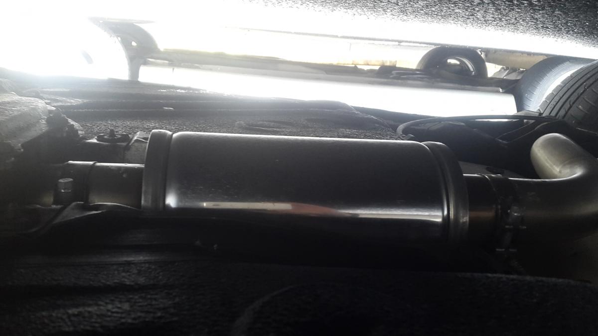

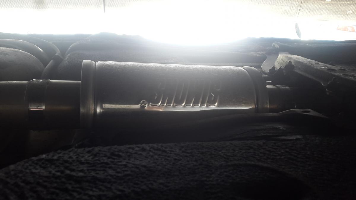

I have a non res piper cat back system, it was quite load so I got hold of piper and asked how much they would charge for a res middle section. They told me they don't do res for my car. I got a small stainless silencer on eBay for just over £60 I think. Made quite a difference but still sounds nice when you put your toe down.

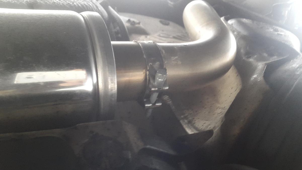

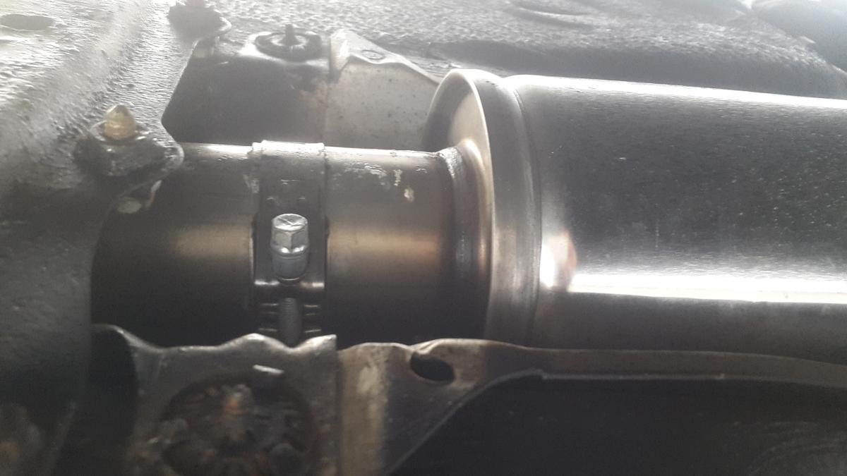

Really easy, I fitted mine with the car on ramps on my drive. I marked it just after the bracket and cut it with a 1mm disk on a grinder, 1mm disk is better as the pipe is stainless. The pipes will slide right inside the silencer ends, I then used those t clamp things coz they look better than u clamps. Job done
Sorry for the rubbish pictures, just took them on my phone
