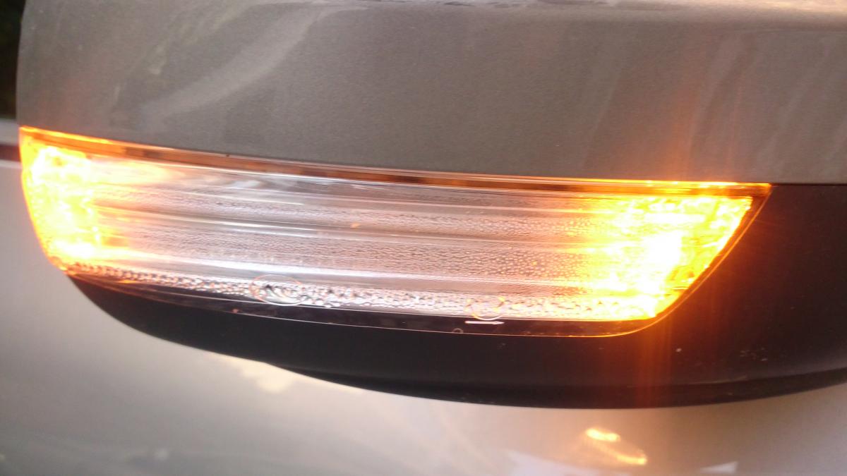

Hello, just noticed today that there is quite a bit of condensation inside the passenger's side wing mirror indicator.
There are actual water beads inside! Will this cause any issues with the LED'S and is there any way of cleaning it without ripping the mirror apart? :(
Years ago Volvo's used to have this problem in the rear lights.
We just drilled a small 3mm hole in the lens at its lowest point.
That cured it.
But if its under warranty get the dealer to look at it.
