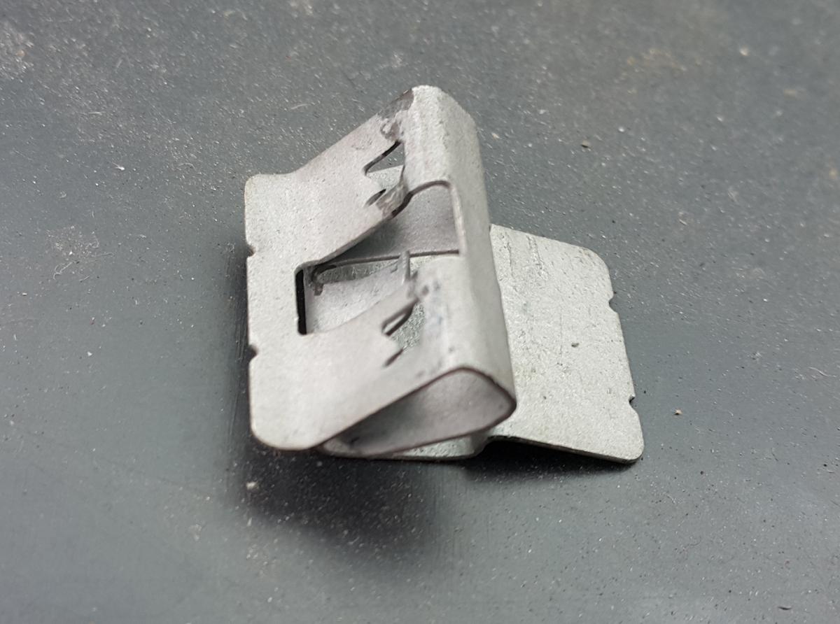

Doesn't seem to be the right part number that if its for the tailgate inner trim panel? I think it might be the metal spring clip that seats into a plastic retainer? I could be wrong though.

yeah the metal spring clip

Plastic clip part number is :- 1H0867981
Metal clip part number is :- 1H0837187A
checked the number on the etos system at work should be spot on if metal one needed updated start of month
one that clips onto platic trim and onto the boot by looks but could be wrong

It will be the length that is the only difference there are others on eBay at differing lengths.
The ones I have remaining look like this
thats the ones i believe
I can't see any similar to order though
