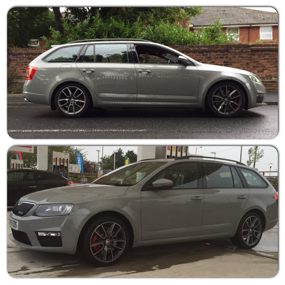

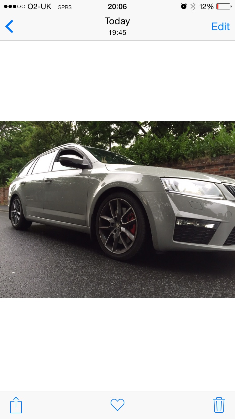

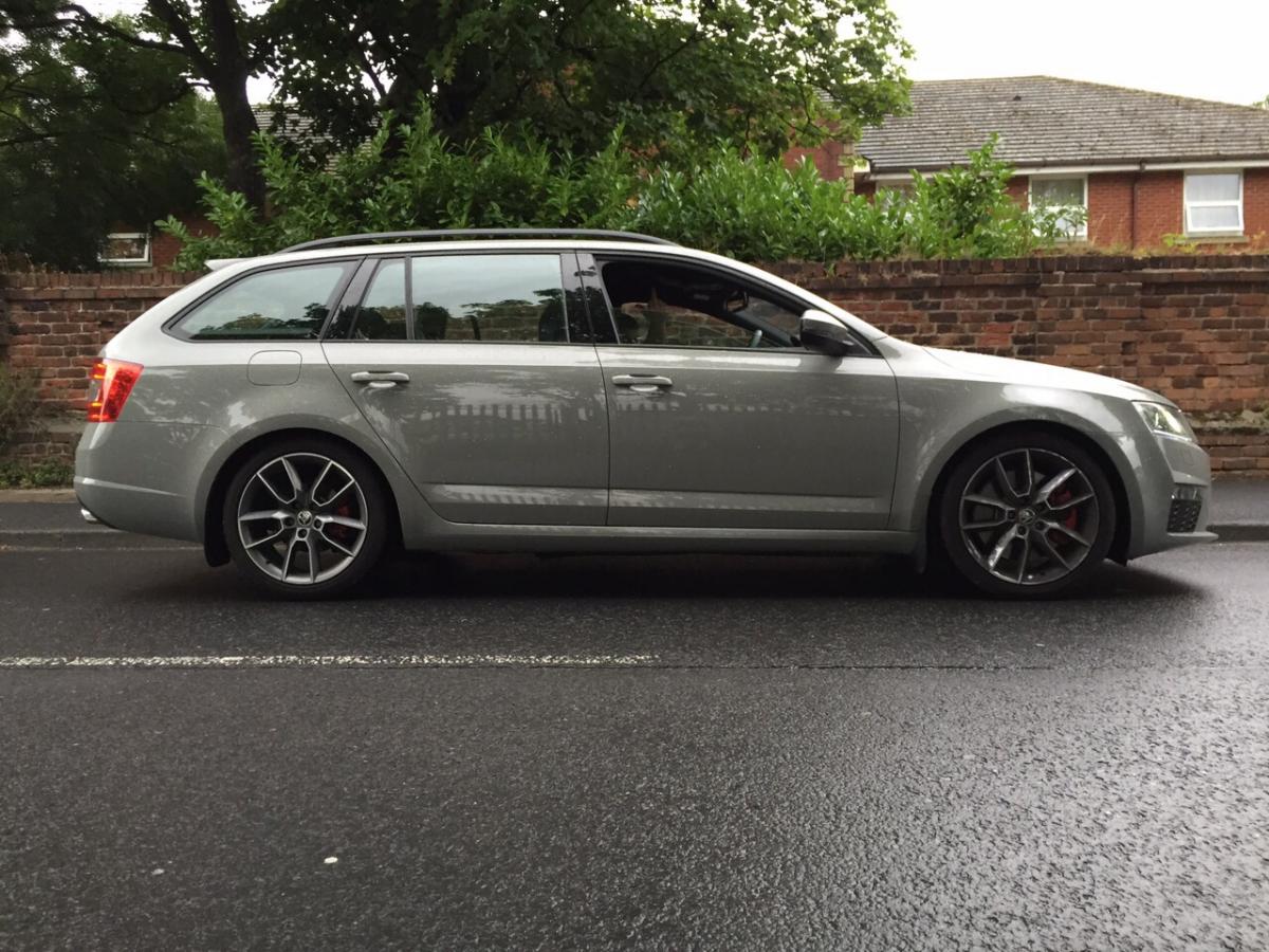

Here's some pics, last one is a before and after
That looks a good height, looks right.  How is the ride?
The ride is spot on, no different to standard in made up with that to be honest! If think the car looks like how it should of done when it left the factory now.
I agree it looks right, neither lowered nor on stilts, just right.
That's it, spacers going on this weekend then I'll get some pics up!
Looks really good and more of a standard look as opposed to some of the other lowering springs. Did the VW springs come from a 3 or 5 door golf? Does it matter???
Petrol or diesel and are they from a mk7 golf R?
