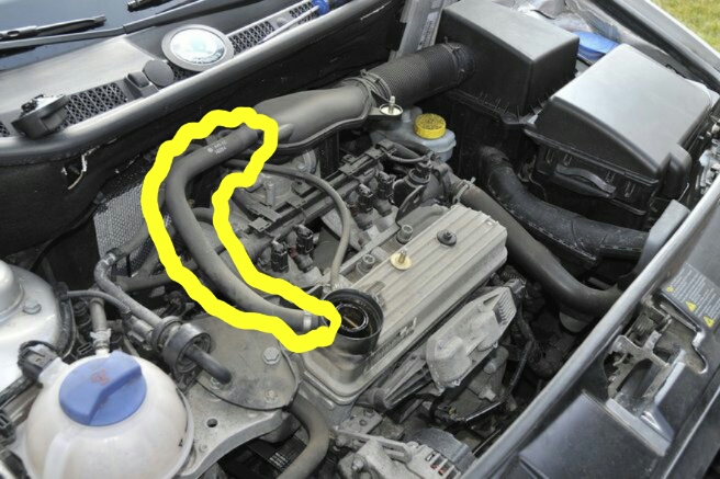

Hope the pic is showing. Anyone knows the part name or part number of the highlighted?
Ideally I would want to replace it with silicon hose
Sent from my SM-N9005 using Tapatalk
047 103 493 F, Oil Breather Vent hose :)
Thank you guys. Will buy and send to my dad
It shouldn't lose oil through that pipe though...there should be only vapours from the crankshaft. If you start the engine without the oil cap on and you rev it, does it spit a significant amount of oil drops through there? If so, I'd say that your throttle body might be pretty clogged so you should at least check it.
Not there anymore. It is just that the pipe has split and needs replacing
