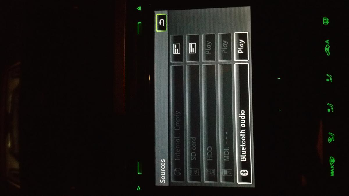

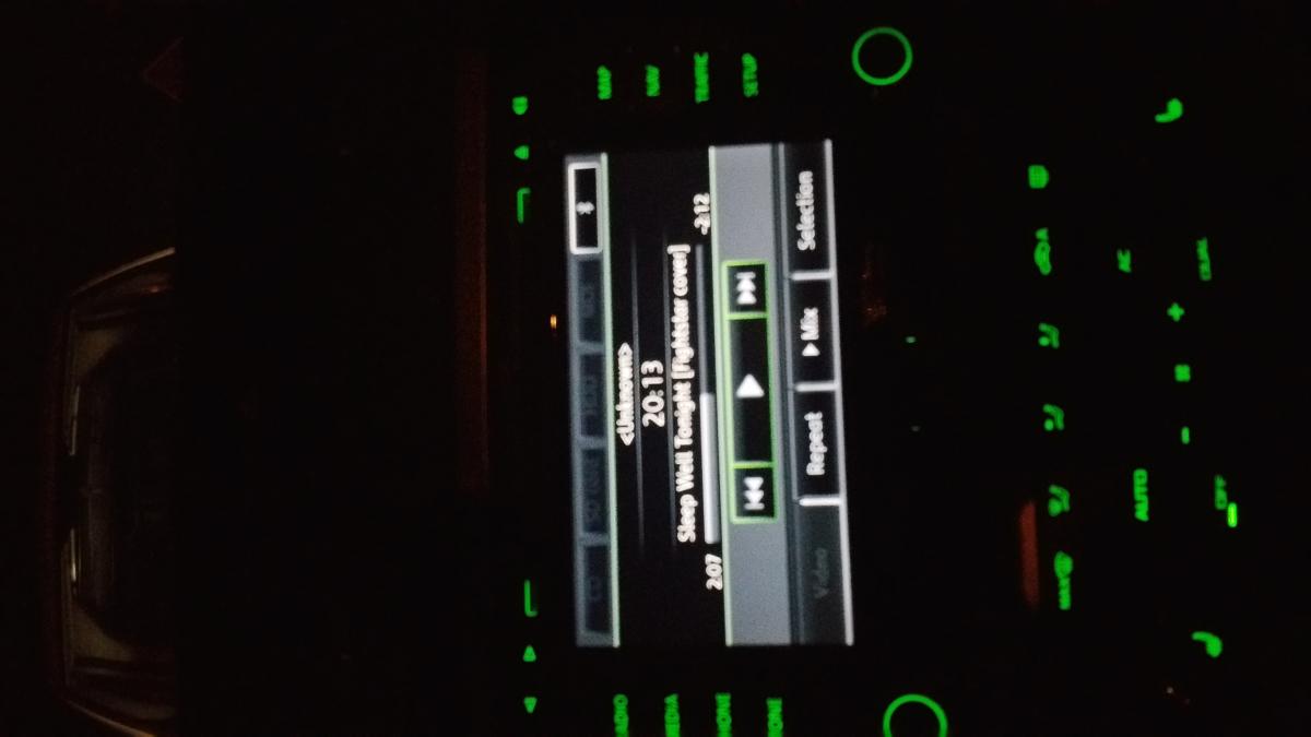

The only other question is... now I have columbus and Bluetooth I should be able to play music throught the bluetooth like I did with the belaro but with the added feature of being able to change tracks from the car not the phone... so once I connect the play music via Bluetooth on the screen comes up with track that playing on my phone and time counting down to the end of the track and I can also change the track on the screen or steering wheel but for some reason I have no sound on either phone or car but when I set it to a basic bluetooth I get sound but can't change track etc please help stuck with this also pictures attached

I am able to stream music from my phone using premium mode so I've no idea what's happening with yours I'm afraid. Might be worth adding a VCDS autoscan just incase there is something obvious included.
