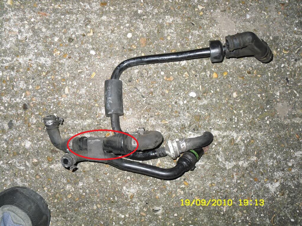

I'm looking for part numbers for the VAC pipe system. I have a leak, circled in the picture below (The picture is taken from this thread "http://www.briskoda.net/forums/topic/221667-how-to-evap-and-vac-breather-lines-simplification/" by Bowders1).
I want to replace this piece and probably the other pipes because I read they are all likely to crack when I try to remove it.

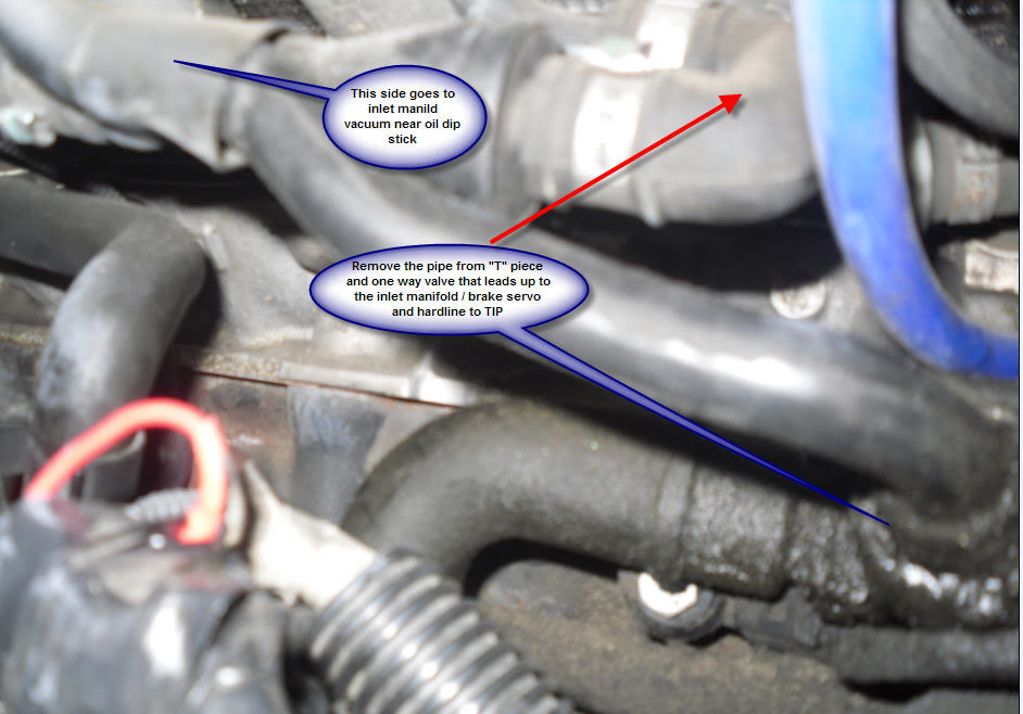

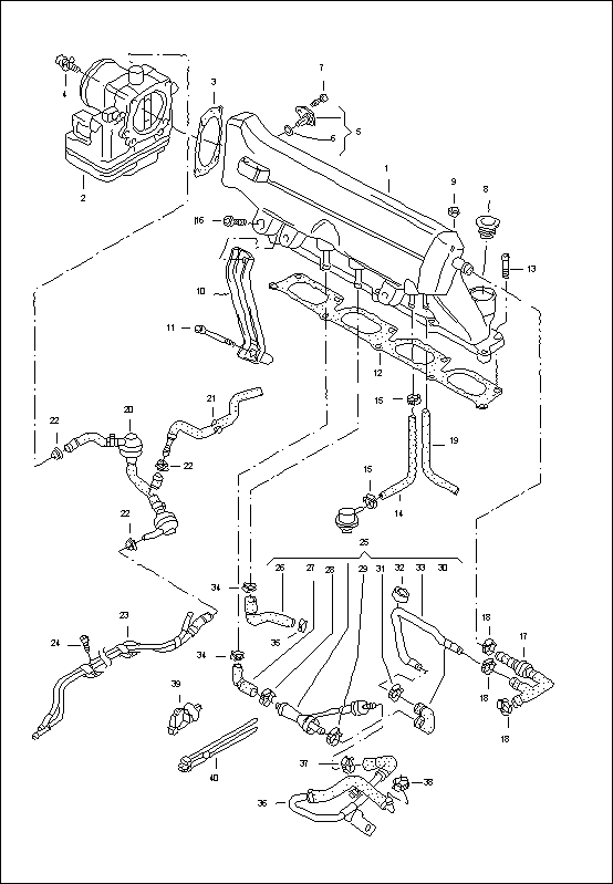

Thanks for the reply. I've attached a few more pictures to give a better idea of what I'm looking at. My mechanic skills are limited enough.
So one of these ones?
Thank you for the reply again. looking at that I'm nearly sure I need the parts encompassed within 25. and I think the leak is in the one marked 25 too. Do you have part numbers for them?
I really appreciate it. I'm hoping this leak is the answer to all my problems; lumpy idle, under performing brakes, boost issues.
Should be this
06a133751a
That's it. I really appreciate it. I've been searching for a while.
To finish it up I came across this guide to replace it http://forums.vwvortex.com/showthread.php?5380569-Suction-pump-DIY-**w-pix**
And I can only see one place on-line to buy it £79.99  http://www.ebay.co.uk/itm/GENUINE-SKODA-OCTAVIA-1-8T-MK1-1U-SUCTION-JET-PUMP-06A133751AE-/321142861266?hash=item4ac59b2dd2
