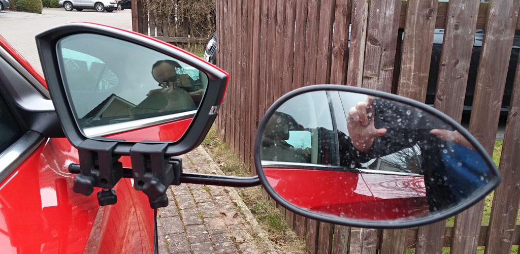

I have Milenco Aeros from my old Superb and they look as if they may fit though I haven't tested yet.  On my old Superb I clamped them at the bottom of the mirror surround rather than the top.
I'll check tomorrow as I may be taking the 'van for a test tow when I've finished washing it.
Test fitted to the driver's side mirror this morning and no trouble at all. I had to adjust the position of the clamps on the bar as the S3 mirror isn't as wide.

Glowing report on the 150 TDI SE Business in Practical Caravan May edition. 5 stars. Interestingly the photos show Milenco Grand Aero's mounted to the top of the Superbs mirrors.
Long winded-post ahead  :dull: .  In summary: mirrors had to go on top in the end. 280 4x4 tows like a dream - 'what caravan?'.
Contrary to my earlier "the Milenco Aero fit ok at the bottom of the mirror housing" post, it would appear that they don't.  The driver side mirror was fine and clamped on without a problem.  The passenger side was another story even though I could see no difference between either the towing mirror clamps or the mirror housing.  There's a small moulding underneath that runs the width of the mirror housing and, for some inexplicable reason, the clamps kept slipping off this at the slightest twist of the towing mirror head.  Oddly, the same moulding is on the driver side mirror and the clamps never slipped at all.
I didn't want to risk the passenger side mirror flying off at speed so I mounted them both to the top of the mirrors, carefully avoiding scratches to the paint, and they were problem free after that.  There's enough space between the mirror glass and the housing to accommodate the clamp and, as the S3 mirrors are smaller, they don't impair vision as they did with the S2.

Well I purchased some milenco aero mirrors today and they fit like a dream on top not bottom due to ridge on mirrors also might hit door when mirrors fold when locking on bottom. Also converted van to 13 pin electrics instead of twin as did not like look of adapters. Was hoping to take van for a test tow but not got round to it will have to wait till Thursday when we're of for a few days in van. Did test electrics and all worked even by accident tested trailer alarm as unplugged van when car locked and alarm went off. Just need to rub hitch surface of so hitch is pads on bare metal. Then ready to go, can't wait.
