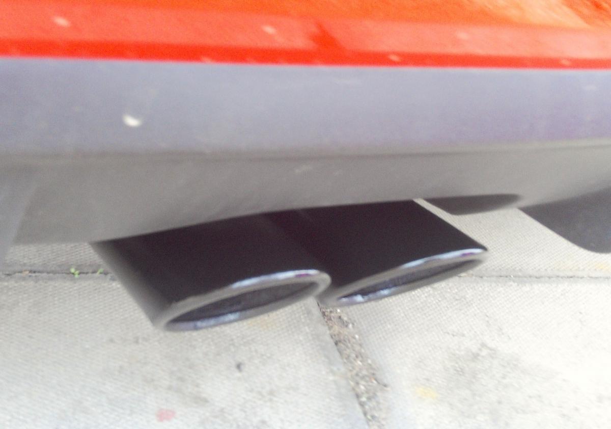

I used to just let the soot build up,
now i paint them Satin Black with Engine Spray paint. Then let the soot build up.

Not difficult is it.
Mask,
Prepare the plastic, use Bumper Primer.
Spray Gloss Black. Total cost 2 rattle cans.
 (& Scouring pads or sandpaper, masking tape, £2)
B&M much cheapness, Halfords more expensive, or use a spray painters services, more expense.

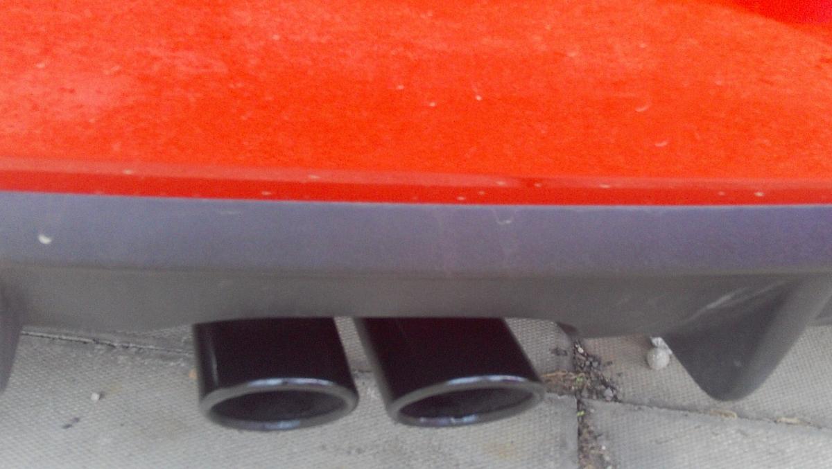

(Excuse the mess of mine, i should be ashamed,
i could not be bothered to paint it, i use Simoniz Back to Black Occasionally *not black but clear*, or Peanut Butter.)

Yeah iv been using back to black on mine occasionally but my freind got his done on his focus n i thought it gave it a more classy look. I will enquire the help of a family member a trained spray painter for the painting of it.
