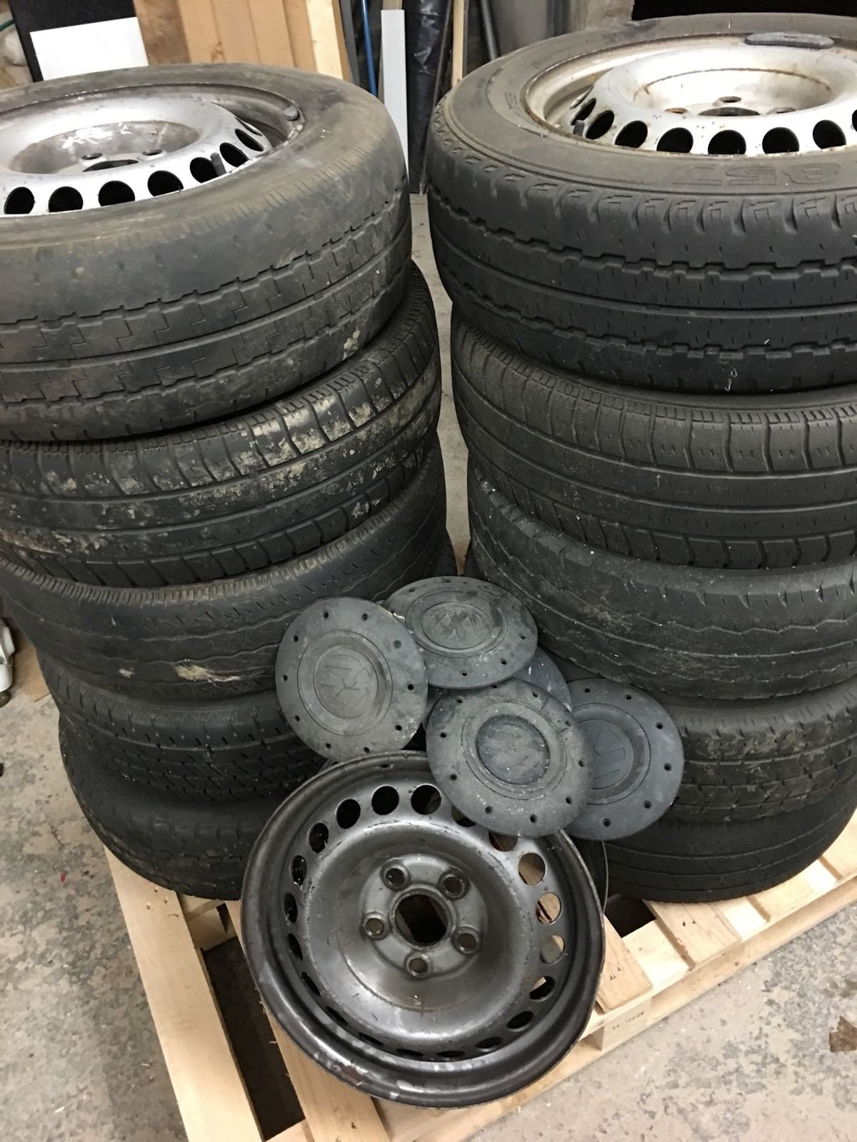

HI all I have just acquired 11 x VW T5 16" steel wheels, currently fitted with 205/65/16c tyres, I would intend to use one set for myself and fit a set of winter tyres to use on my Octavia combi 4x4.
My question is does anyone know if these will bolt straight on or do I need a set of nuts or different bolts etc etc ....

No they won't fit.
They're 5x120 PCD where as the Octavia is 5x112, and the centre bore is also too big.
You'd be better off selling them on as you'd have to faff about with adapters, and it's not worth it.
T4 and Caddy wheels will fit the Octavia however.
