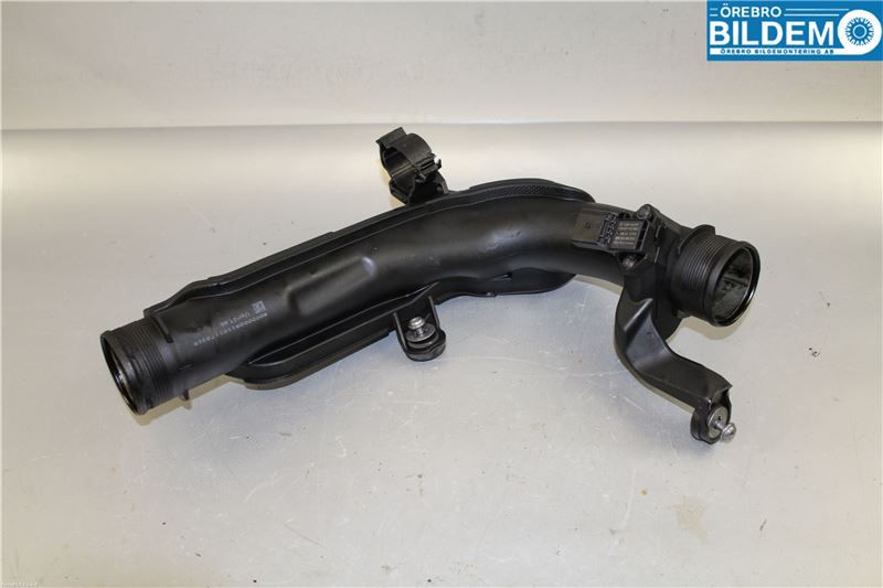

here's a Picture for some idea:
Heureka!
I have located it - on the PC so far.
In our car (Sweden) it is located on the left side - drivers side. The Picture below - it is located on the right side - but I found it in the car with help of these pics!!

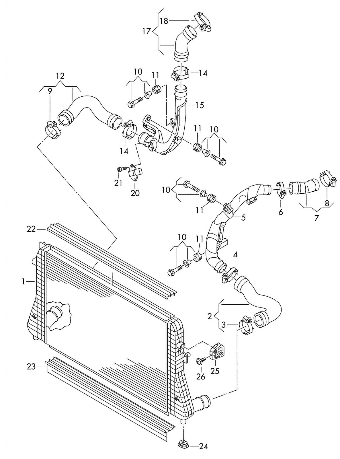

Is it item 20 in this diagram?  Found at This link.
