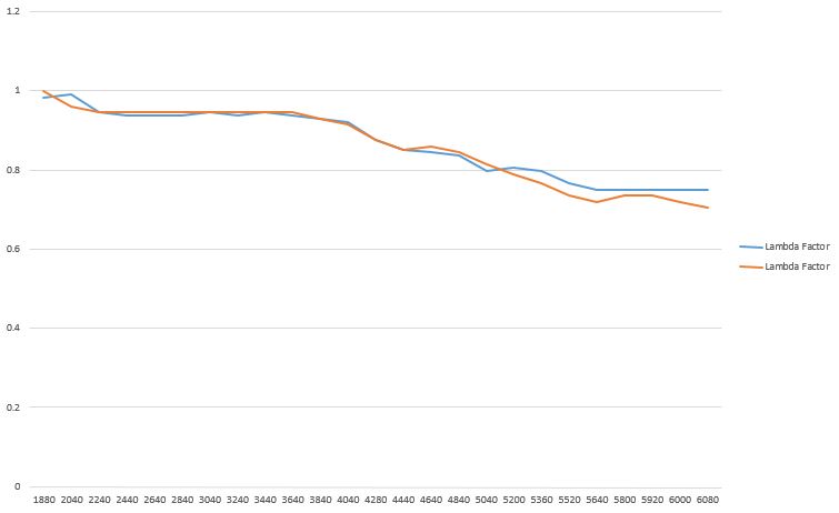

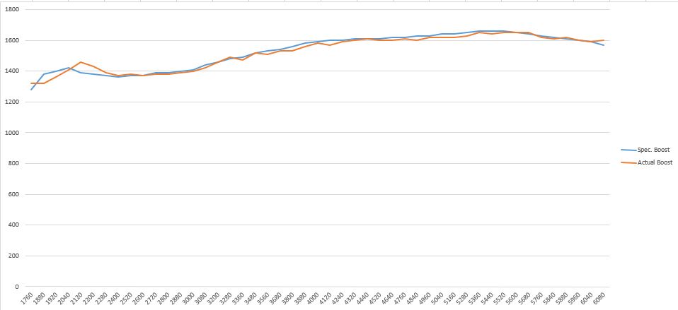

attached a file of block 115 i did yesterday
don't know if theres any point putting it up as i found busted breather hose yesterday too but what the hell

Boost looks fine and stock to me as does your air fuel ratio.
Thanks for the help John. So thats as it should be for a stock setup...
