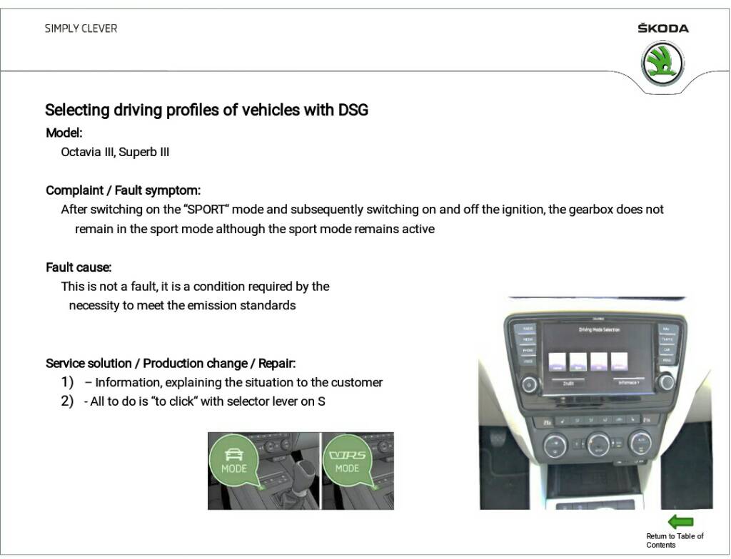

Basically I set the drive mode to sport for journey A and when I later start the car for journey B the Columbus, and the button beside the gear handle, says sport mode is on but the maxidot shows it's in normal mode which driving quickly confirms.
If it can remember the setting (as shown by the Columbus & button) then why not apply to the engine/gearbox? What is the point in resetting part of something the driver has decided to change?

Just had it in the dealer & mechanic says he thinks it's "the way it's supposed to work" despite everything on the main display including the info (when in mode selection tells you what each item is set to) saying that full sport mode is on (including drive) but maxidot and actual driving confirming it's not...

I have this every day - my Superb's Drive Mode is permanently in "SPORT".
Each time I start the car, it starts in "D" not "S". (I have DSG by the way)
It can't start in "S".

Well I got an answer from Skoda...apparently done on purpose for economy reasons...
