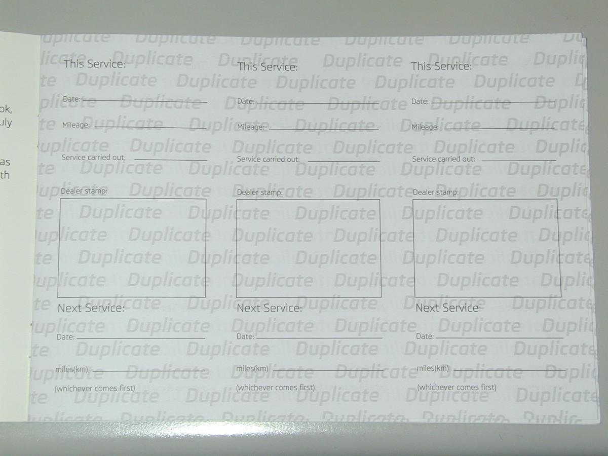

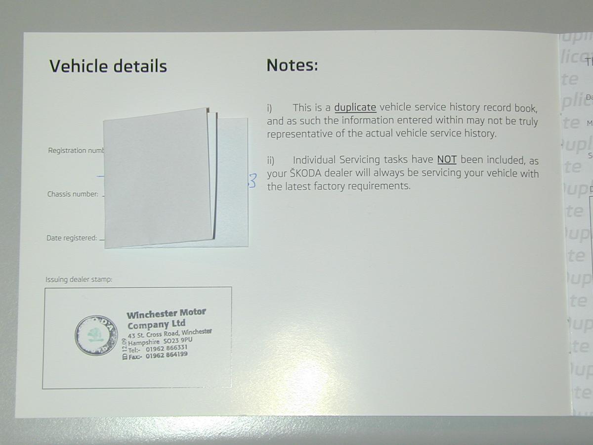

When I bought the car it came with a service. The sicker on the side of the dash say 2 years or 20,000 miles. The display says 8000 to a service. Unfortunately My dealer is a bit naff and I can't get any info on what service it should be on. My service book is a replacement 1 which was not stamped and the car has no build codes. I have stripped out the false floor and spare wheel I fitted and there is no sticker there. Is there anywhere else I can find out what the build codes are for my car.

Go to a Skoda dealer and ask them for the build spec.

The cars is 2010 and it has a replacement service book. I had the whole boot out and all foam trim and no sticker at all so starting to wonder if it's been in an accident, and been replaced. The matrix says 253 days or 7500 miles, as it was serviced 2.5 months ago I guess it was never reset. I sticker on the side of the dash says 20,000 or 2 years but nothing to prove this. I heard there was an app where you could put a chassis number and get service details. Is this correct and do they do it for the iphone?

That looks like its been set on annual servicing.
As above looks like annual service as its too short for variable especially if it was serviced just 2.5 months ago

I would agree with Urrell, that sounds like you are on "Fixed" servicing, which is 12 monthly or 10000 miles, which ever comes first.
