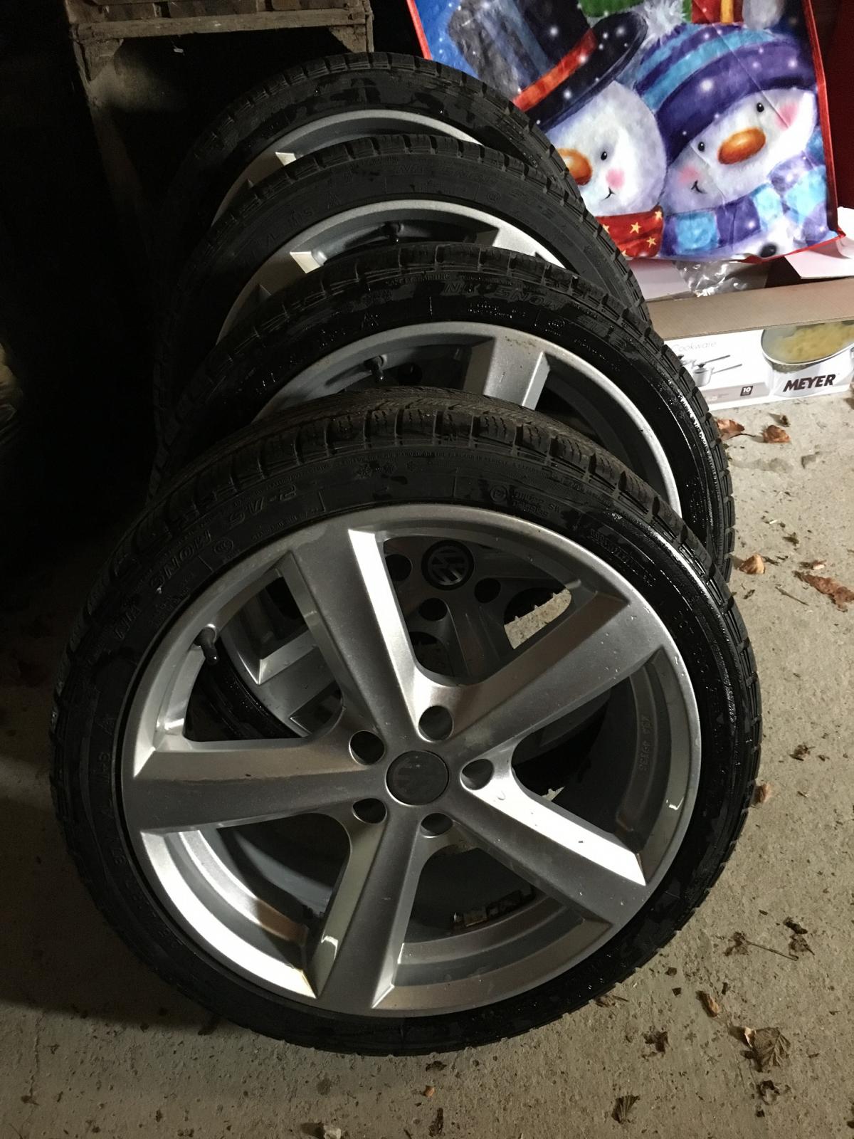

Hi guys,
on my 1.2 fabia I have arrowspeed tyres on the original 15 inch alloys,
I have been given a full set of the 17 inch tyres with brand new mud and snow tyres on, absolutely free
The only thing i do not want to do with the wheels is sell them, as they were a gift.
So should i put the 17s on the car now and not really be bothered about the winter tyres?
I drive down country roads which are pretty mudded up,
any ideas?

Look nice. Maybe post a pic when they are fitted. Considering 17" to replace my 15".
