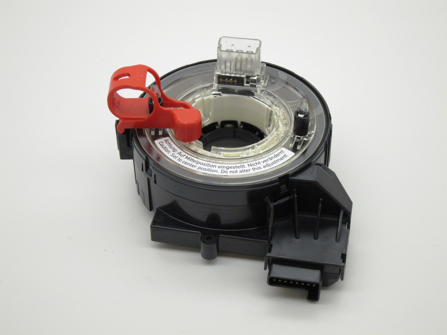

I bought the VRS Multi function Steering Wheel (MFSW)  the one that control the
DSG gear and the radio,
I received with it Part number: 1K0953549CH  which should control it.
for some reason I can't connect it to the slip ring, I think it doesn't suitable for this VRS MFSW.
can anyone help me?
what parts should I buy? do I need to replace the slip ring with this Steering Wheel Slip Ring 1K0959653C ?
do I need the  cruise control stalk 1K0 953 513 G
For-VW-Golf-6-MK6-Cruise-Control-System-
I also saw something that i may need the 5Q0953549A   Multifunction Steering Wheel Controler for Octavia 3
or 5Q0907530AC Gateway Controler for Skoda Octavia 3
can someone tell me what parts (with part numbers) I need in order to make it work?

You have the newer style, instead of it just being a control module, it will probably have the stalks attached and you'll swap the entire lot over.
I have the following fitted which supports a MFSW, cruise control and is without buttons for the MFD (not needed with a MFSW).
Address 16: Steering wheel (J527)       Labels: 5K0-953-569.clb
   Part No SW: 5K0 953 521 BN    HW: 5K0 953 569 E
Rosstech also list some other compatible modules at the bottom of this page: http://wiki.ross-tech.com/wiki/index.php/Steering_Wheel_Control_Module_Versions
Just make sure that both the module and stalks are correct for you car as they come with/without buttons for the MFD and cruise control.

Thank you for your response
but I don't understand ,
i have this:
Part No SW: 5K0 953 521 AN HW: 5K0 953 569
so what Steering Wheel Slip Ring will fit to it? can you write me the part number?
and does the control module 1K0953549CH   will fit?
how can I make it work?
Thanks
Shlomi
Octavia 2 Facelift used 3 different types of slip ring and control module
2009 - Early 2010 would use the 1K0 953 549CH type of controller and a C version slip ring
Mid 2010 - 2013 would use a 5K0 module which has the slip ring built in
There were 2 versions of the 5K0 module / slip ring.
5K0 953 549 Version made by Kostal
5K0 953 569 Version made by Valeo
Your best option is to find a 5K0 953 569H or L or AL
don't buy any 569 type that is for the passat

Hi
Thank you for your reply
I found these:
http://www.ebay.com/itm/VW-Sharan-7N-Seat-Alhambra-Lenkstockschalter-5K0953569H-5K0953502R-5K0953501BA-/272158377233?hash=item3f5de74511:g:gewAAOSwu1VW3CwT&vxp=mtr
http://www.ebay.com/itm/Volkswagen-Audi-Seat-Skoda-Slip-Squib-Ring-5K0-953-569AL-5K0953569AL/252364370390?_trksid=p2045573.c100033.m2042&_trkparms=aid%3D111001%26algo%3DREC.SEED%26ao%3D1%26asc%3D36461%26meid%3D22112f9d0dd641caa7d5d49071ee95e7%26pid%3D100033%26rk%3D3%26rkt%3D4%26sd%3D380255477853
http://www.ebay.com/itm/VW-Audi-Passat-Tempomat-Elektronikmodul-Lenkstock-5K0-953-569-L-5K0953569L-/141962325142?hash=item210d9d2c96:g:pscAAOxy3NBSh6xp
If I buy one of these can I use the control unit 1K0 953 549CH with it?
do you think the cruise control unit
http://www.ebay.com/itm/262335196539?_trksid=p2055119.m1438.l2649&ssPageName=STRK%3AMEBIDX%3AIT
will work with it?
Thanks
Shlomi

sorry this is what i have
