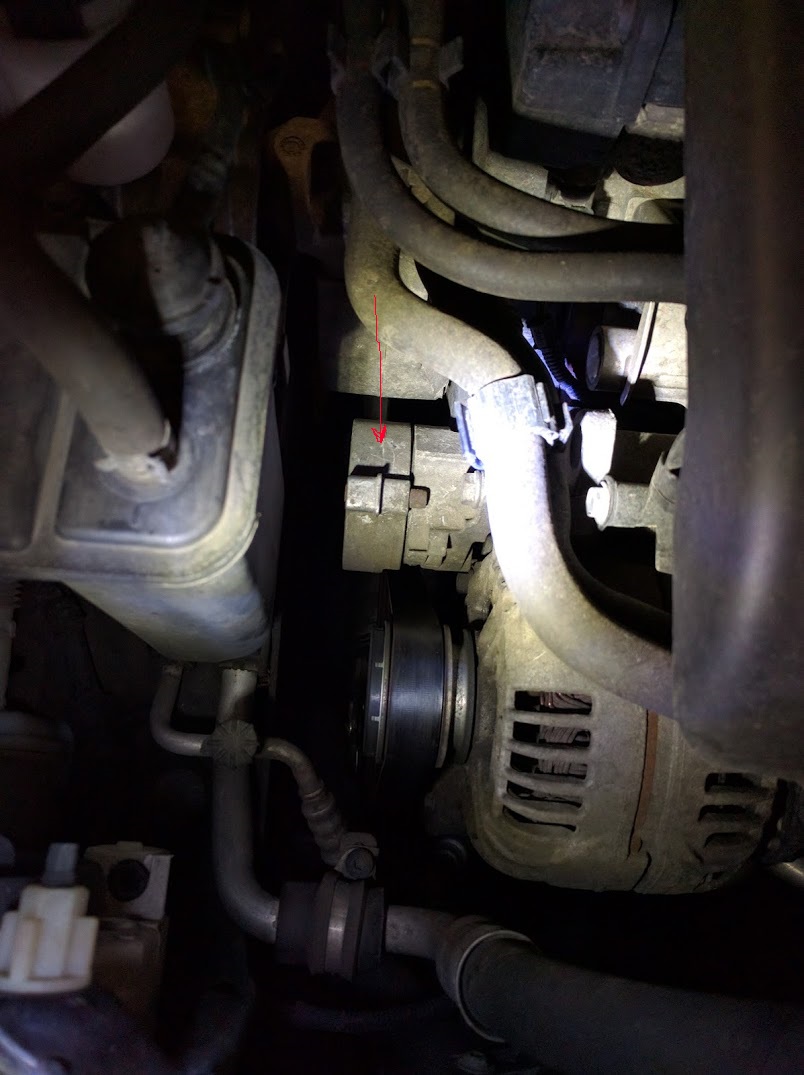

Tinkered with it some more and I *think* the sound is coming from the cam belt tensioner. Unfortunately I don't have a stethoscope or a really long screwdriver to listen to it, however just holding a screwdriver onto it I can kind of feel the vibrations in my hand in time with the noise which is a repeating "tap-tap-tap" at idle with maybe half a second pause in between. I didn't know the tensioner can actually make such noise and of course I'm not 100% it is the cause.
Is there any surefire way to diagnose it short of replacing it? Also, should I minimize the driving until I get it replaced?
Btw, is the tensioner supposed to be vibrating? By this I mean that it's not holding perfectly still, but it's rather moving towards the back and front of the car...like, I can see the pin on its right moving.
Edited by jmf
^ cam belt tensioner = serpentine belt tensioner :)
if you think its a tensioner then I would advise against driving the car until you can be sure. it could fail suddenly and leave you stranded.
It was the tensioner, was replaced and the sound is gone. Additionally it looks like the serpentine belt was never changed  :peek:  (car has 160k km) and had already the top layer broken in two places, matter of days probably before it went completely.
