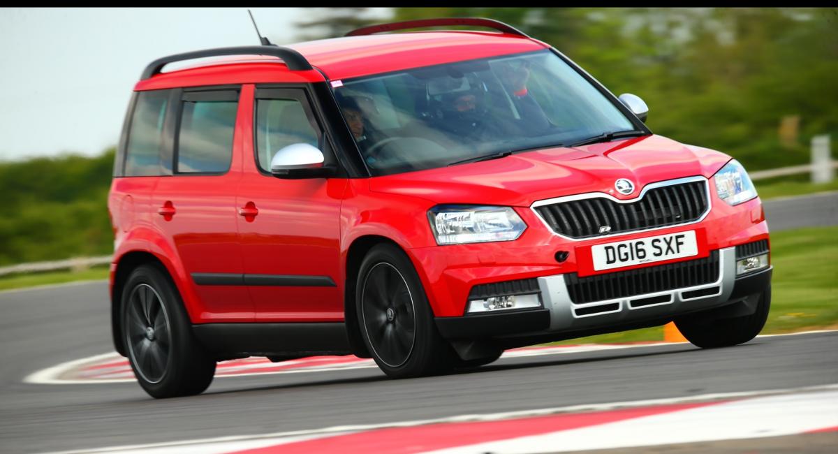

I've B6 paired with Eibach on the Yeti and the ride is just better in every way, just as comfortable at low speed but exceptional handeling and motorway speed ( and above on track) stability, certainly worth doing.
