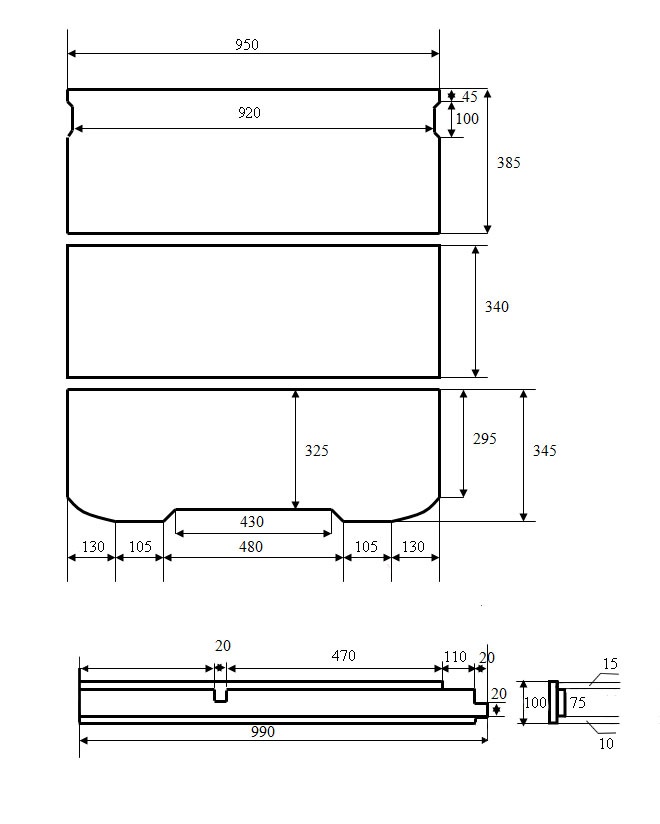

You could even try and make your own, I've attached some dimensions I found on another site which should be correct for a hatch. The top is 10mm plywood and the two struts are 20mm thick from what I understood.
10mm ply would not hold much weight. The original for the estate is 25mm thick, possibly made up of two or three thicknesses bonded together.
