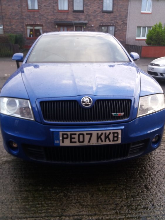

  My car is a 07 vrs pre face lift. I'm 99% the face lift is the same badges. I've recently swapped all my badges to the new style badge. The part numbers you'll need are:
5J0 853 621 AUL : front badge
5J0 853 621 AAUL : rear badge
5JA 601 151 FOD : mk3 Octavia wheels.
Please note the double A and single A in the p/n. Front badge is 88mm rear is 78mm iir. Last thing to say, I ordered a new front badge from TPS yesterday, and received a call from them today telling me that it's going to be a wait of 5 working days. Not sure as to why.

That badge definitely fits the pre face lift grill without any pegs needing removed. Size was correct as well. As mentioned, I'm certain the face lift is the same badge.
