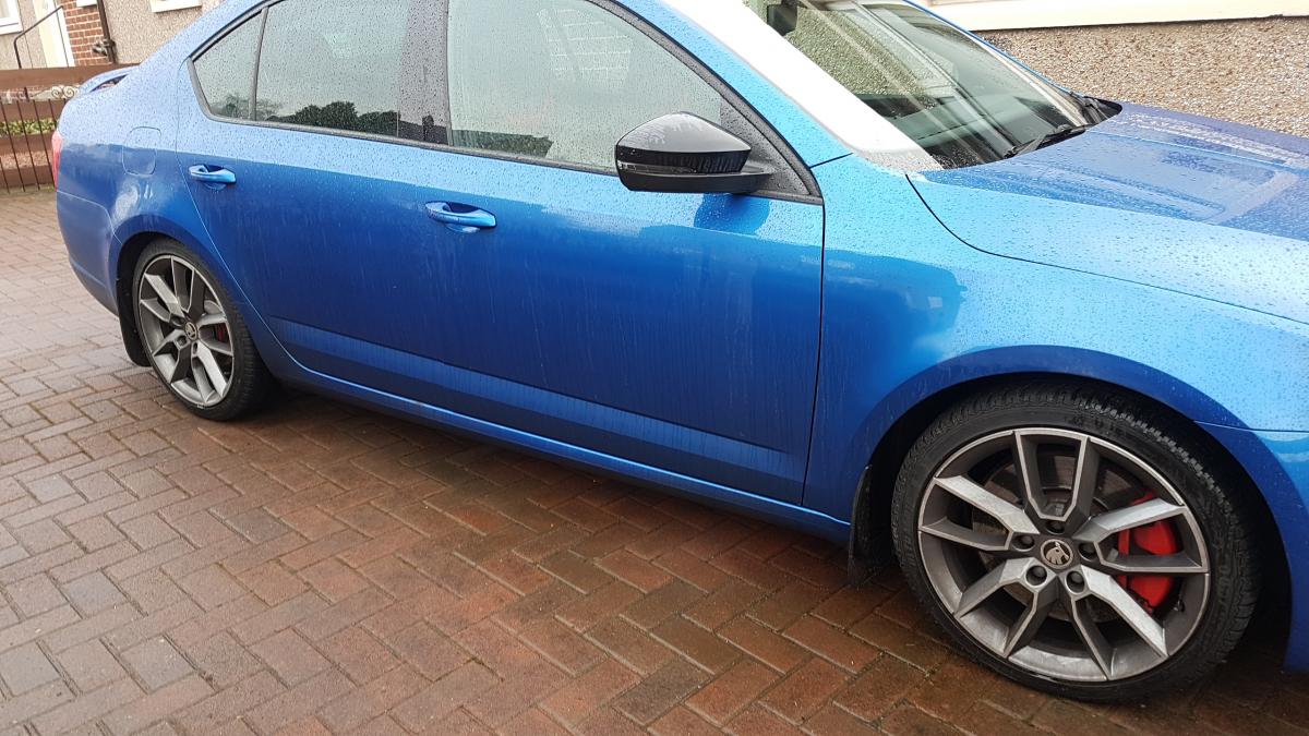

358mm rear. 356mm frt. Or if you prefer from the ground...frt 652mm rear 654mm
Sitting on VW RACING coil springs
