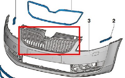

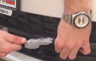

The bulb in the front left fog lamp died 3 days after the car went in for its service. As the manual makes it look easy to replace I thought I'd have a go at replacing it...but it's not so easy when you've never done it before. After hunting around on this site I came up with the following. Hopefully it'll help someone else out in a similar
predicament
1. From the manual.
2. Screengrab from post in this forum.Looks like he's using the flat bladed screwdriver from the toolkit to remove the RHS grill

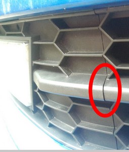

3. Grill on LHS with a red circle showing where to stick the screwdriver
Does anyone know if it's possible to remove the top grill (one above the number plate) without taking the front bumper off?
Thanks
No, not in one piece.
It is melted to the bumber from behind.
This only applies to non-vRS right? vRS bulbs need to be removed from the inside.
Yes, that's how I did it.
So was I.
The frame is easily removable, the grill is not.

Found this replacement grill on superskoda website. It's a honeycomb design not a slated one. I'd rather shell out for this than a complete bumper & grill assembly
http://www.superskoda.com/Skoda/OCTAVIA-III/Octavia-III-front-grille-in-OEM-honeycomb-design-KI-R
The website suggests getting it fitted professionally so I am wondering if this is quite a complex task.
Think I might just live with my (slightly) cracked grill - curse that bloody pigeon.
Complex?
Well, remove the bumper, cut out the welded bits and use some force to take the old grill out.
Insert new grill, weld or glue it to the bumper and install bumper back.
On Superskoda site they say it's a 2-3 hours work but I would double the estimate.
