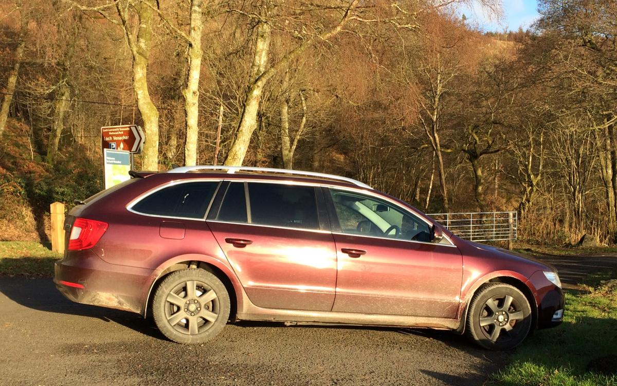

I deliberately took our Superb out for a run today because it's been sitting idle outside the house since Christmas Eve.
I could see the brakes covered in rust film.
I wasn't surprised when it fired up immediately and ran happily for a 100 mile jaunt. Some of Scotland's scenery at its best.
