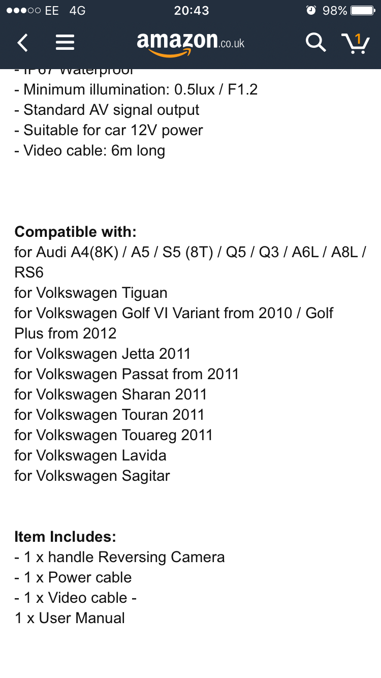

Im looking at this camera.
LIEBMAYA 170 degree Car Trunk Handle Backup Camera Rear View HD Camera parking camera for Audi A4 A5 S5 Q5 for VW Passat Tiguan Golf Passat Touran Jetta Sharan Touareg https://www.amazon.co.uk/dp/B01G3134FC/ref=cm_sw_r_cp_api_mQMHybPXRWSKN
Please see attached photo for the list of cars it fits.
anyone know if the handles are the same as an Octy FL? I would imagine they are but I would like to know for sure.

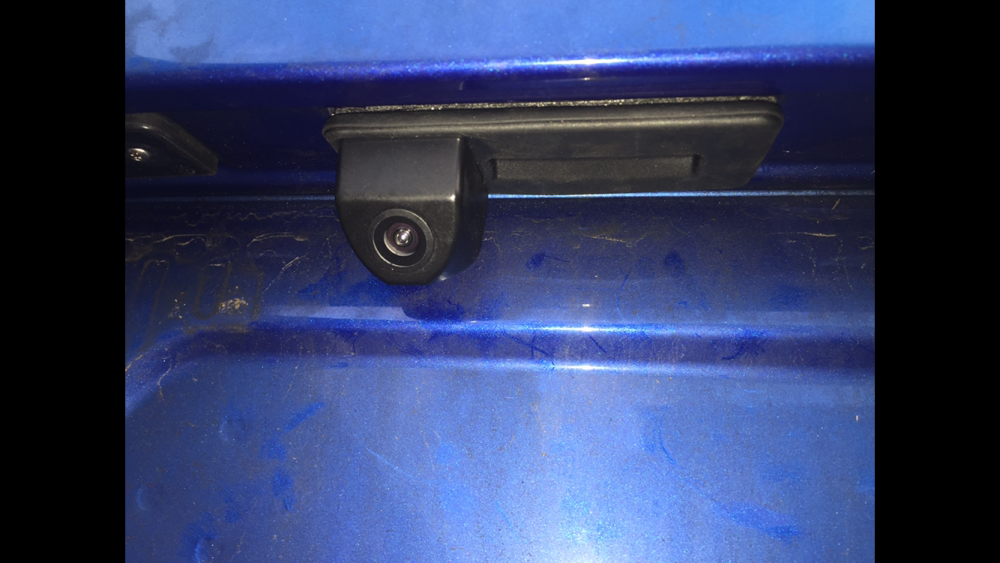

I've run the wires through the boot gator and into the car which wasn't too difficult.
I've just got to run the cable through the headlining and into the head unit now.
Probably an hour or two job by the time I run the external mic that I need to connect up too.

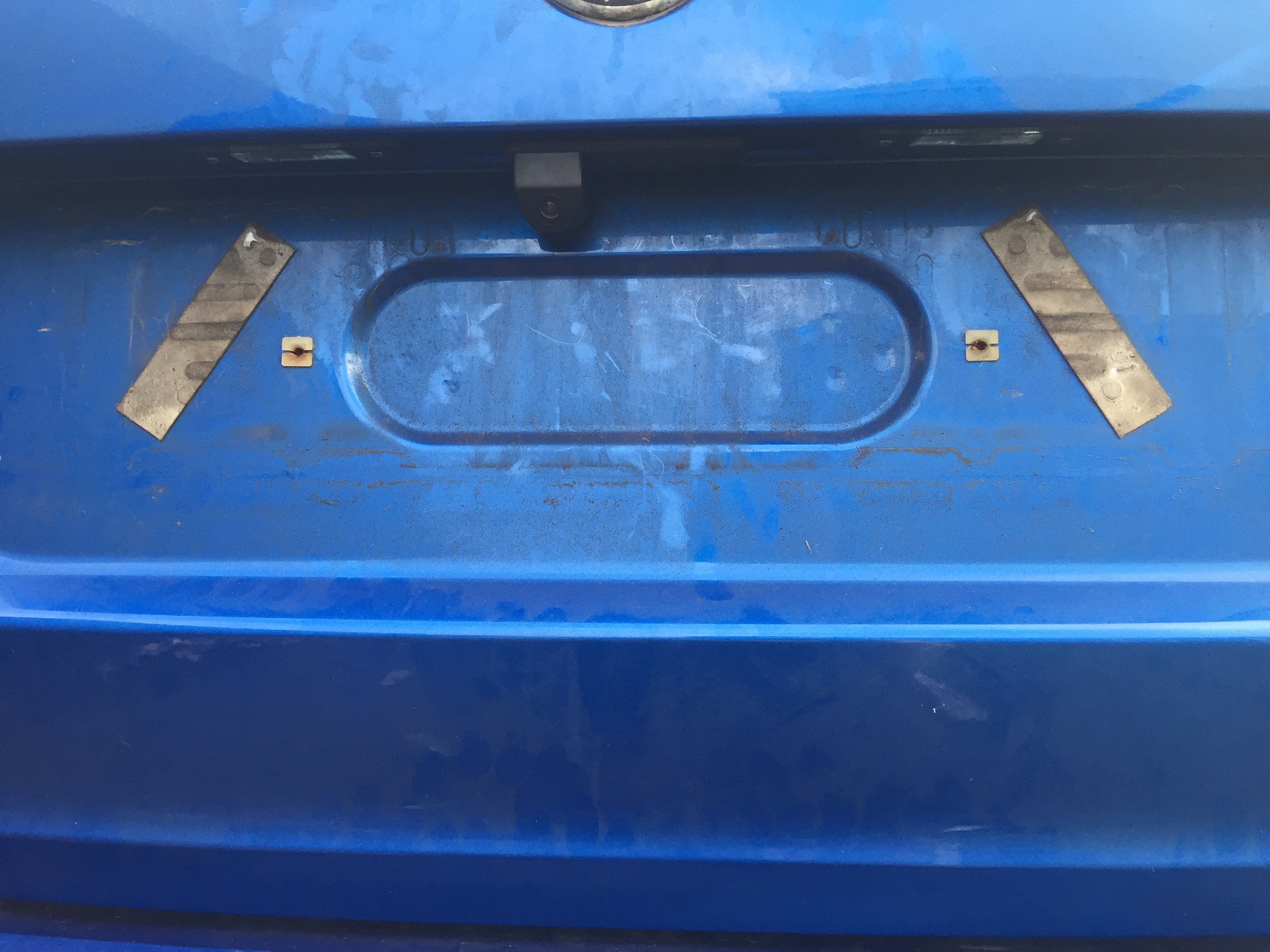

Looks the same as mine. Are you happy with it?

 I got as far as i can get with it tonight, lashing rain wasn't helping the job!
Anyway i managed to get it hooked up as much to do a test with it to check the camera and it worked perfectly :) Fed off the boot light and have run the RCA lead into the back of the head unit, i didn't connect the red trigger wire but it appears i don't need to, must be the canbus doing its job?!
Engine running, select reverse and the camera comes on, out of reverse and is back to the radio. i'll wait till the weekend to route it in properly but so far so good.

Did you take your feed from the rear interior boot light? I have run into problems when doing that, for some reason when i close the boot the picture goes blank on the screen, also when i lock the car the boot lights start flashing!
I know i have a different HU but these Chinese aftermarket ones are all fairly similar.  I've run the RCA cable from the back of the HU and connected to the camera, the power + & - are spliced into the boot light + & -.
Also did you have any issues with the connection for the multiplug on the boot latch, the prongs on the aftermarket latch are much wider!
Sorry for the late reply.
I took the feed from the head unit. It comes from the canbus so it's only live when reverse is engaged.
You have wired yours to the boot light.
The boot light is only only live when the boot is open, hence the camera receiving no power when the boot lid is closed.
You need to wire it to the reverse light because that is always live when the reverse gear is engaged. That will definitely solve your problem.

The solution was staring at me all the time but i just couldn't see it! Like you I've wired it to the head unit and the canbus sorts it when its in reverse.
