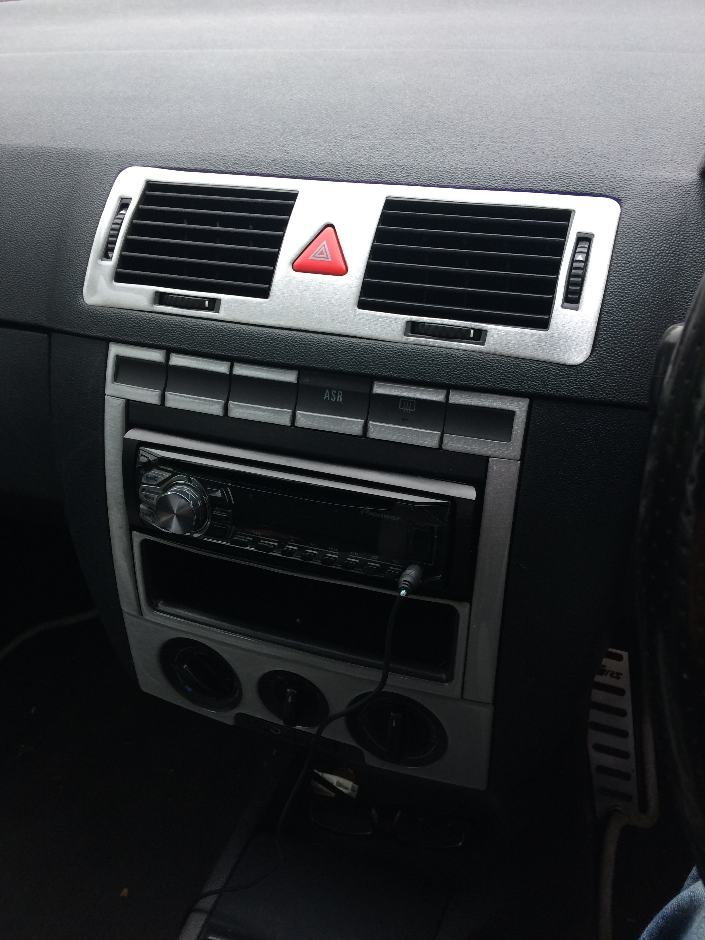

Ok so it turns out a previous owner had the cd / vent surrounds etc - changed to silver.  Not sure why... Personal taste I guess.  Not for me - So I guess I can just remove each part that's silver taking care and vinyl wrap it however I like and refit?

Exactly that. Be careful prising them out, try and prise from a few different angles, so as not to snap any of the clips. There are a couple of really awkward metal ones that hold the centre vents in place, take care not to drop them as you remove the vent, they're a right faff to find behind the dashboard, and if left - rattle like you wouldn't believe.
You will have a better idea when you remove the trim and see what I mean.
Also remember to unplug the hazard light behind it before you remove it all the way, to ensure you don't snap/stretch it.
JRJG

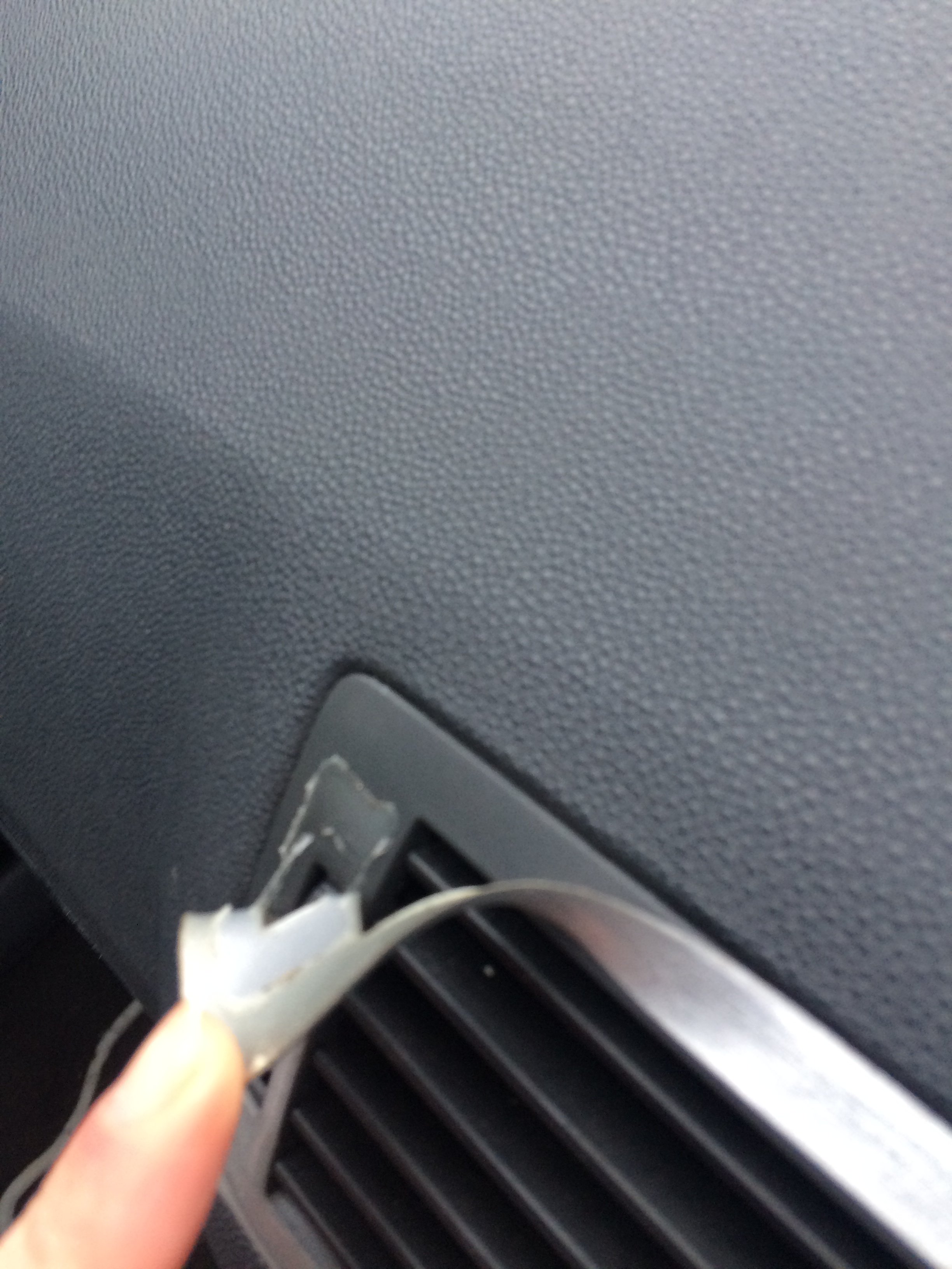

From what you said before - behind this silver later there is black plastic. So my assumption is that I can heat gun this silver **** off and take it back to original?
If if this is the case then win win as I wanted it black anyway so saves me money!

I don't understand why ;D  I'd be happy to heat gun them off and send you the pre cut sheets.  You'd just need to reglue them on - up to you but if you pay the postage it's no problem.w
Cheer for the offer but if they're gonna be pulled off I would prefer to either spray or wrap them myself :)
No problem :)
I'll probably wrap them myself at a later point.  Right now I just want rid of the silver trim. Was going to do it today but thought I'd wait and hear back from you so I knew what the plan was
Got the heat gun and alcohol cleaner ready :D
Thanks for the help guys
I used an old bank card to remove those trim bits then had them painted gloss black.
